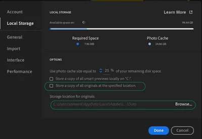

In Adobe Lightroom, please share the screenshot of the options below from Preferences.

  • Here is the screenshot of Preferences\Local Storage:
