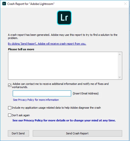

Lightroom crashes before it even opens a window
  • January 19, 2019
  • 587 views
I click open
I get this crash report window
Then i am left wandering why adobe wont talk to a paying customer, instead pushing me to a user forum??
Hahahahahahahaahaaaaaa
I have tried
- uninstalling, removing preferences
- rebooting
- re-installing
and the problem persists

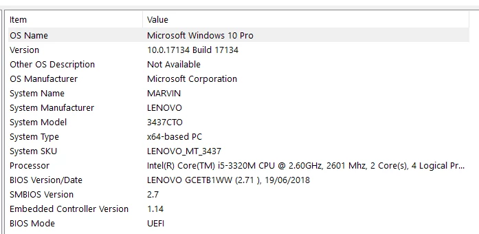

jasonh57366982
January 19, 2019
Hi cmgap,
I am logged in on the creative cloud app from which I am launching lightroom from.  Also, if launched from the start menu it also crashes before a window is shown.
Photoshop opens fine.
system details below.
