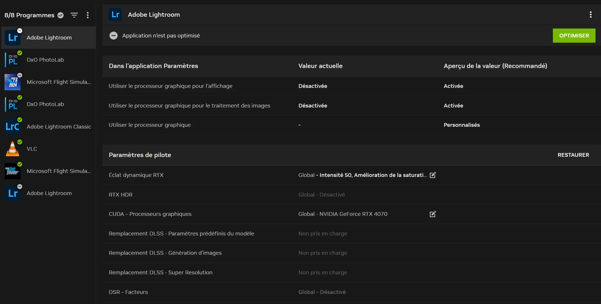

Bonjour Lighroom et Photoshop ne sont pas reconnus par Nvidia RTX 4070 ce qui me genere enormement de probleme
Comment puis je reparer ce conflit

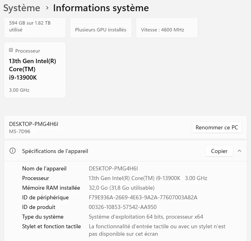

Your machine has two GPUs: the power-saving Intel® 770 UHD Graphics and the high-performance Nvidia RTX 4070.
Please try these two suggestions:
1 - Update the graphics drivers using Intel & Nvidia's auto-detect program.
2 - Follow step 6 in the content here to configure the default GPU for Lightroom & Photoshop: https://adobe.ly/49YQSCI
