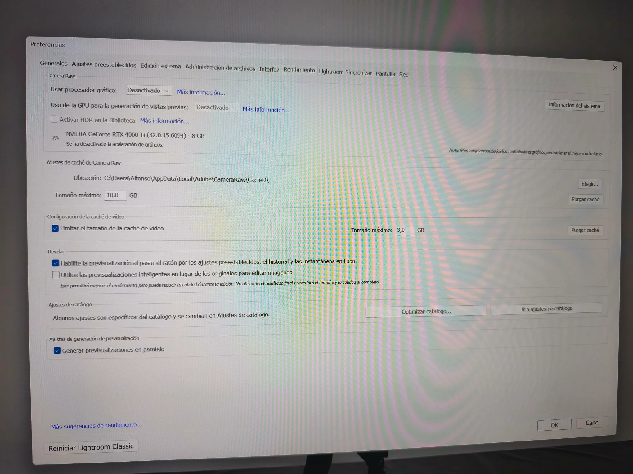

Oct 27, 2025 1:59 PM UTC
Nada. He deshabilitado el uso del procesador de gráficos y suigue igual. Le envío foto con la configuración.

Thanks for sharing the info!
Go to the Edit menu in Lightroom, then Preferences, then Performance, and disable the option to Use Graphics Processor. Once you've done this, relaunch Lightroom to see if that makes a difference.
