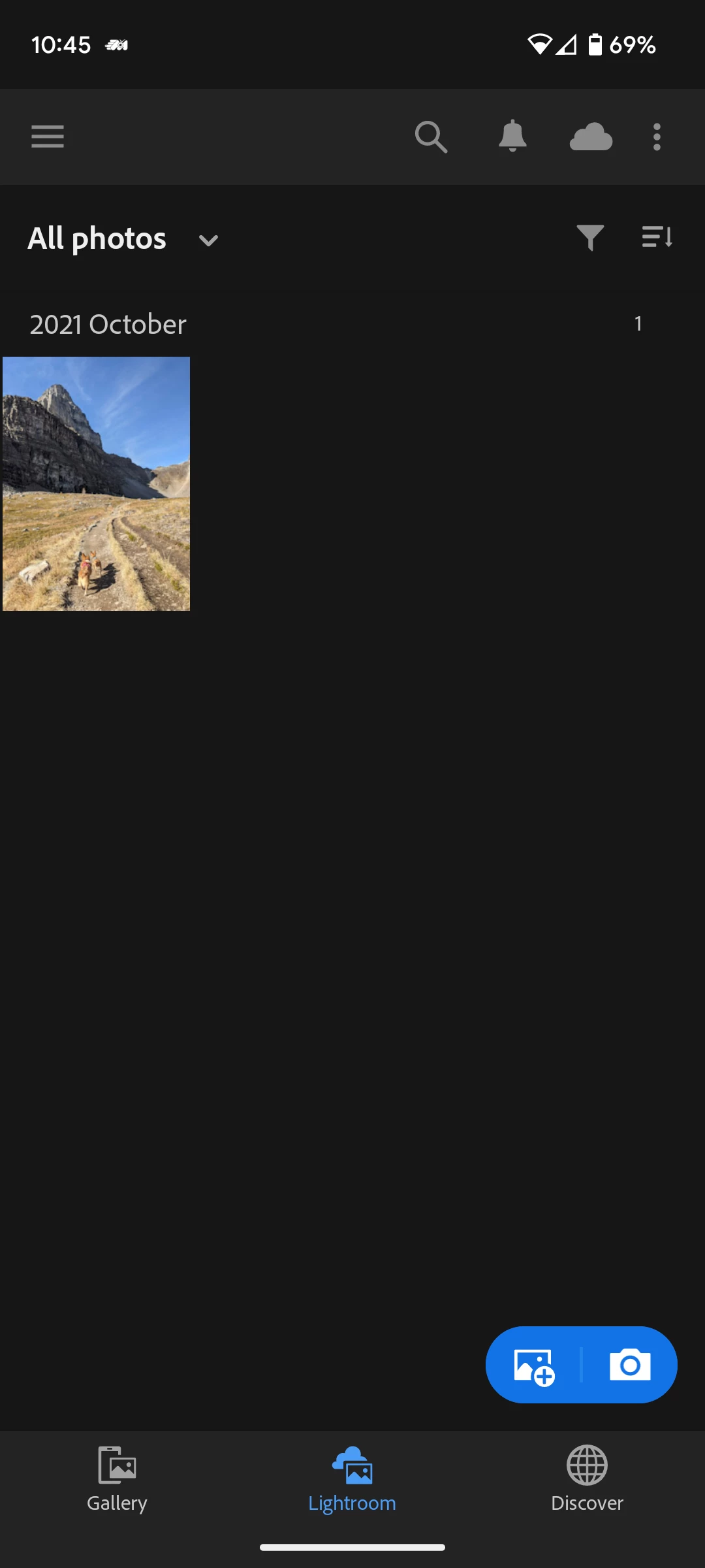

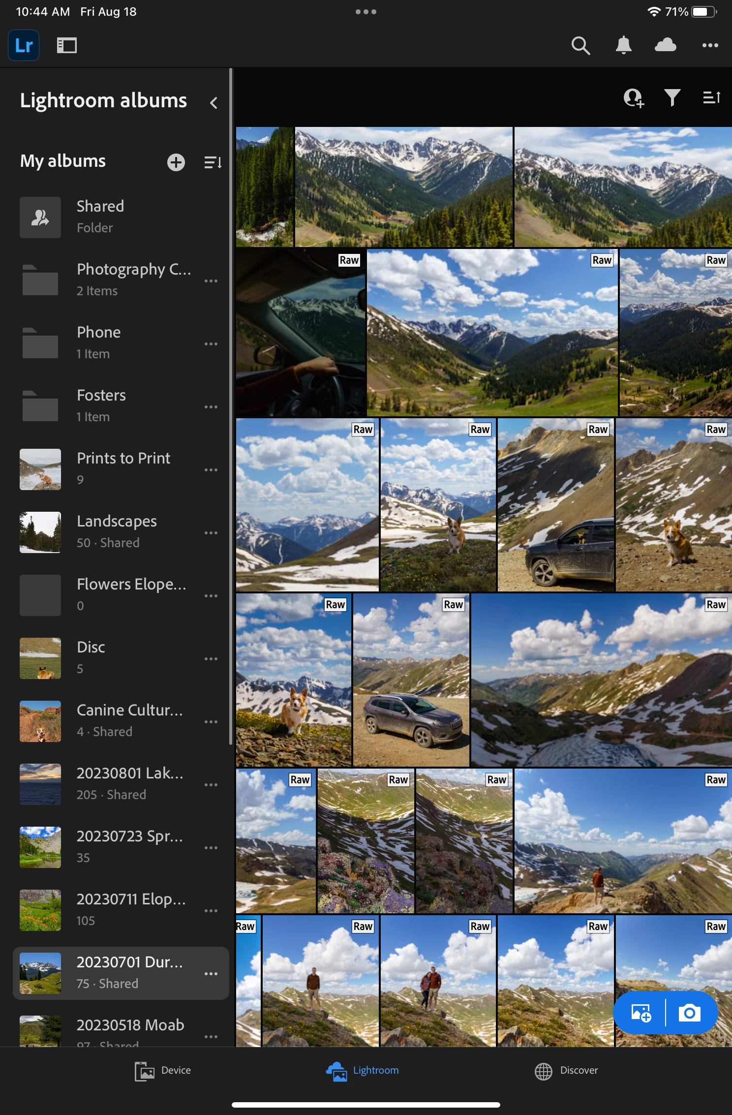

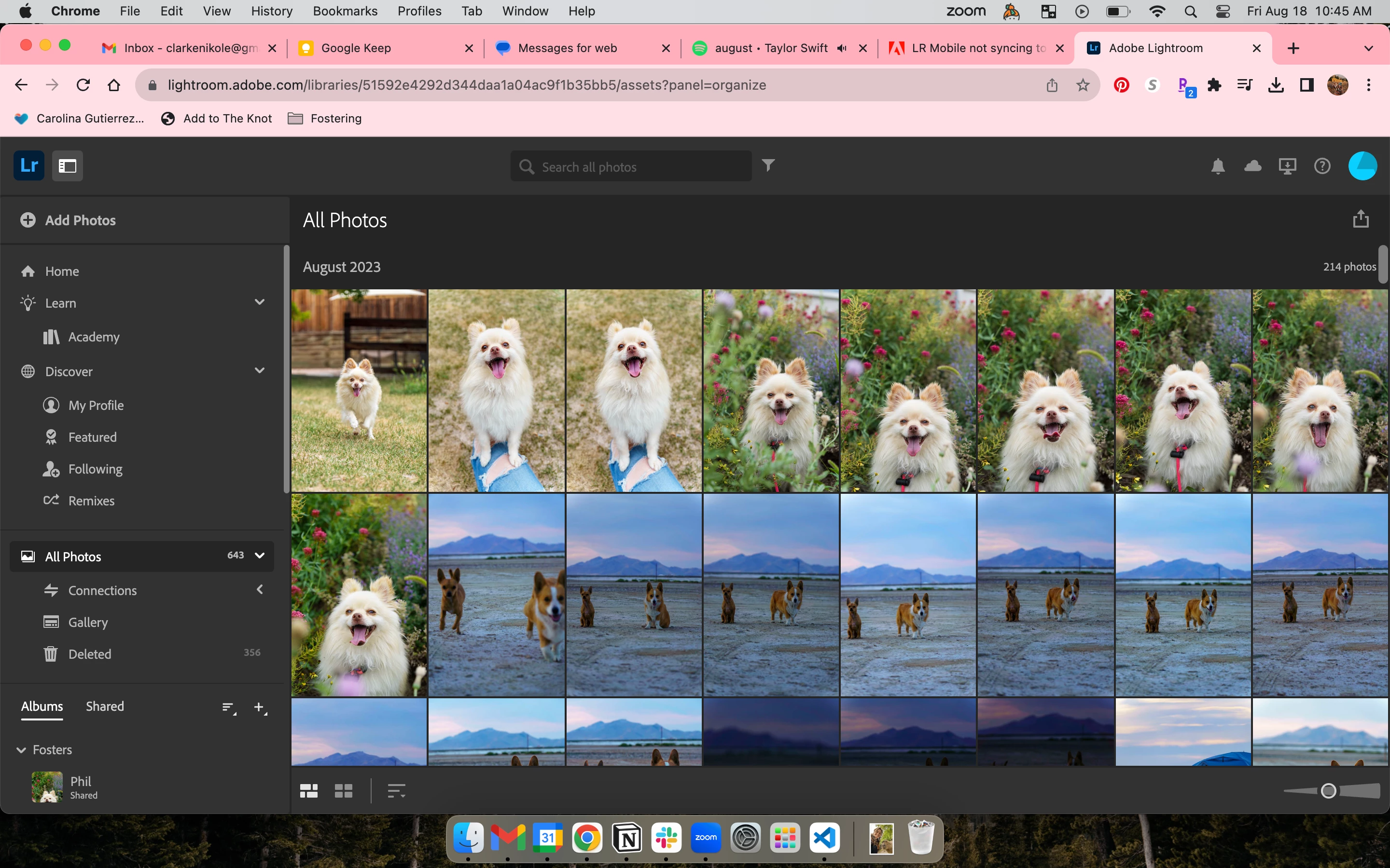

LR Mobile not syncing to new device
I got a new phone and LR won't sync to it. My LR Mobile for iPad and LR Cloud both sync. I tried chatting but the Virtual Assistant said I don't have a paid plan so I can't chat with a real person 🙃

Did you try to log out and log in on three devices ? Maybe the sync was stopped on one of them
I did! After a week, LR on my new device synced with the cloud. I tried many things yesterday, but I think uninstalling it from my old device actually fixed it. I read somewhere on the website that LR only syncs between three devices...my new phone would have been the fourth since LR was still installed/logged-in on my old device.
