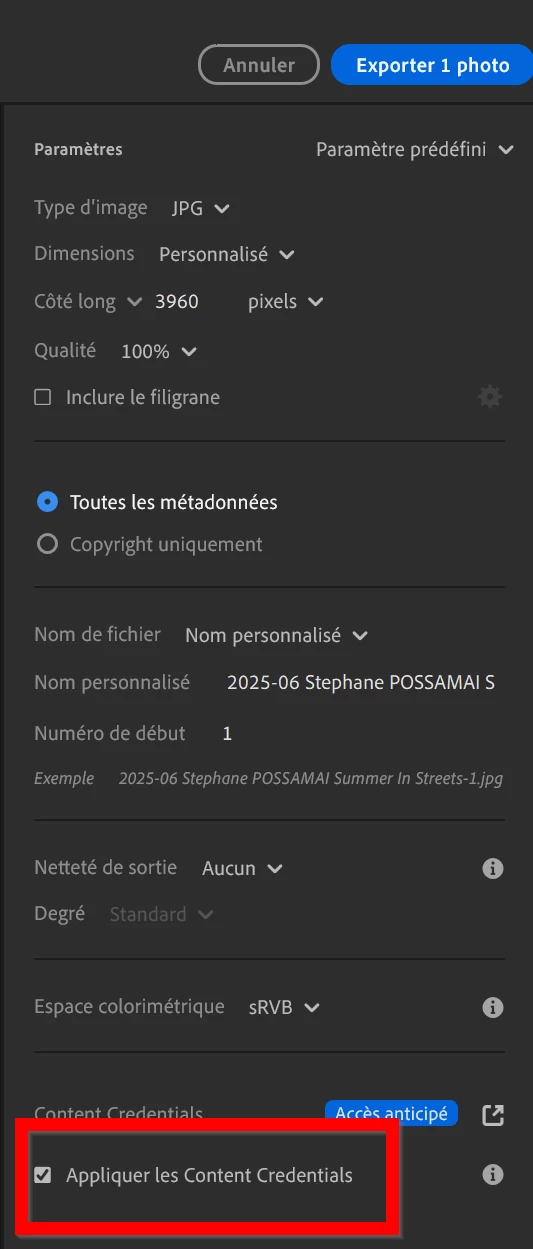

I'm using the latest version of Lightroom, and I'm running into a serious issue when trying to export JPEGs with Content Credentials enabled.
When I leave the Content Credentials option checked in the export module, nothing happens. The export doesn't start, and I get no error message – it just silently fails. I’ve had to completely uncheck the Content Credentials option to make the export work at all.

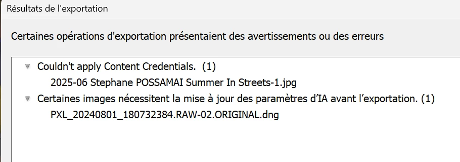

When I set the contents credentials I go this error and the pictures doesn't export

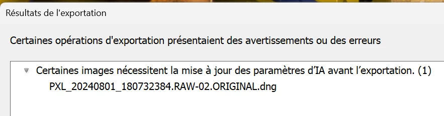

And when I uncheck the content credentials checkbox, I can export export the picture but I still have the message: "
  • "Some pictures require AI settings to be updated before export."
And then the pictures is exported but I'm not sure if every parameter I uses (for example mask on the sky) is applied on the output picture...

Hi @stefposs! Thanks so much for the screenshots.
Sometimes Content Credentials won’t apply if the file is over 20MB. Could you double-check the file size just in case? It can also run into issues if there are already other credentials attached that are too large to store in the cloud.
To help us look into the "some pictures require AI settings to be updated before export" more closely, could you let me know what specific AI edits you’re making to the photos?
