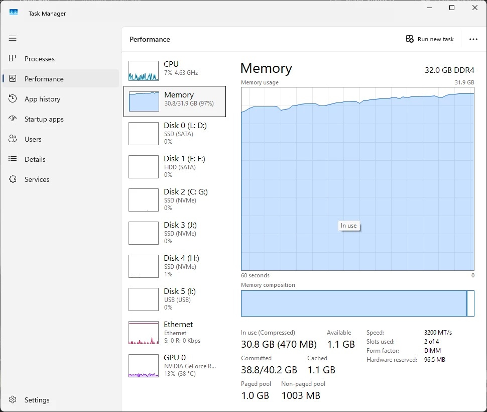

memory leak
lightroom cloud on windows 11 32gb ram, ryzen 9 5950x, geforce rtx 5060 is using up to 95 % ram during assisted culling - all software and windows completely up to date

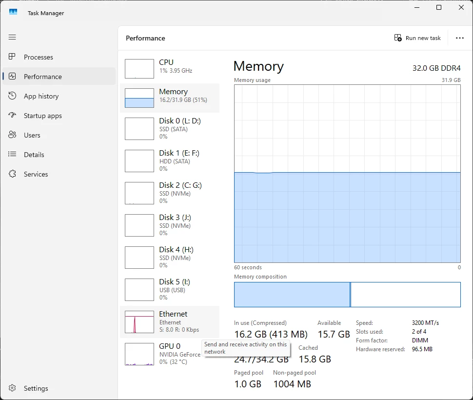

    What remains an issue is that Lightroom does not seem to release memory after a task is completed. For example , I was just doing some more culling, and memory usage went up to around 40%. As I was doing this, I also decided to denoise one shot, which pushed memory usage up to around 80% (still fine), but once denoise was completed, memory in use remained at 26.4GB with committed reading 32.5/40.3 GB Cached 4.8GB. Culling has also stopped but memory usage is sitting at these figures. Shouldn’t this memory be released at this point?

    Id I turn off use graphics processor, this does not happen and memory usage sits at around 40%
