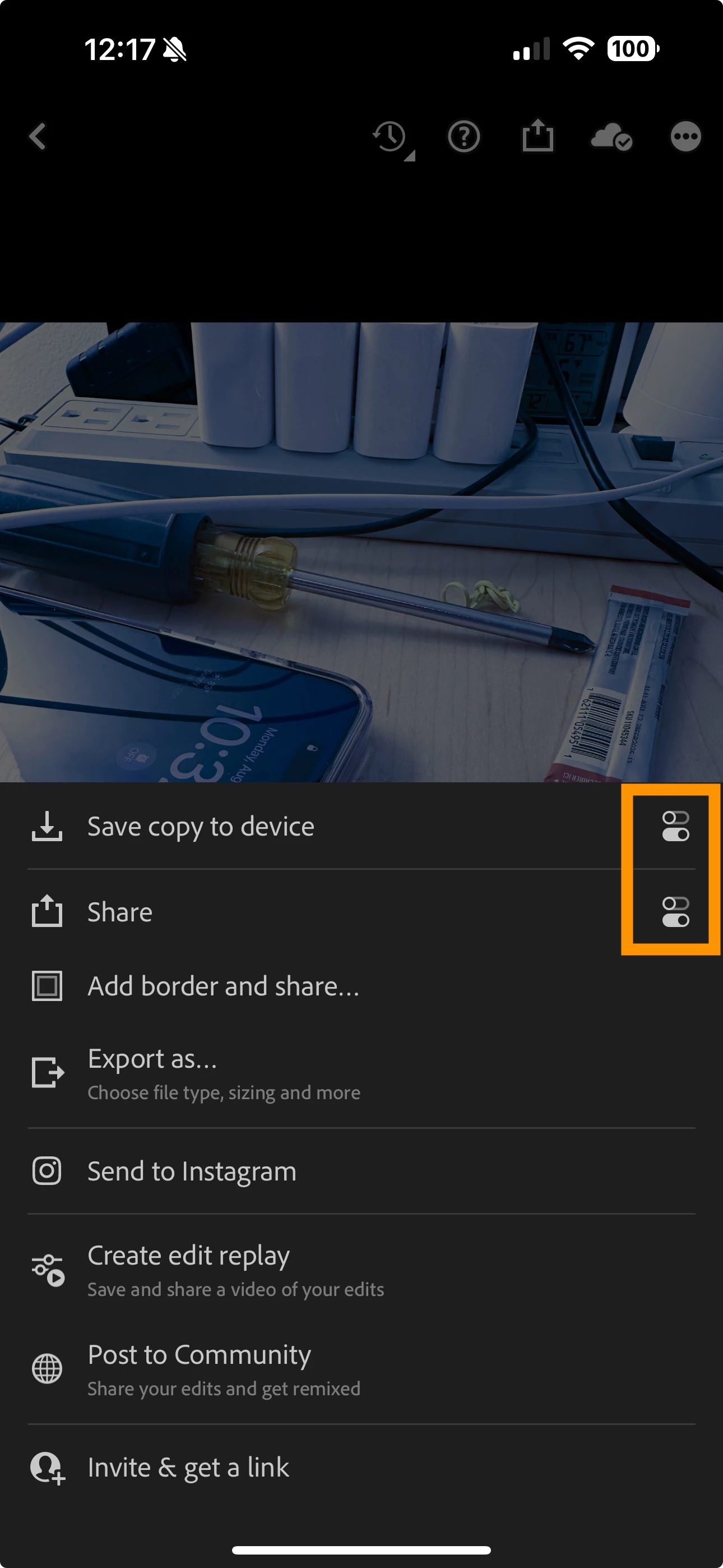

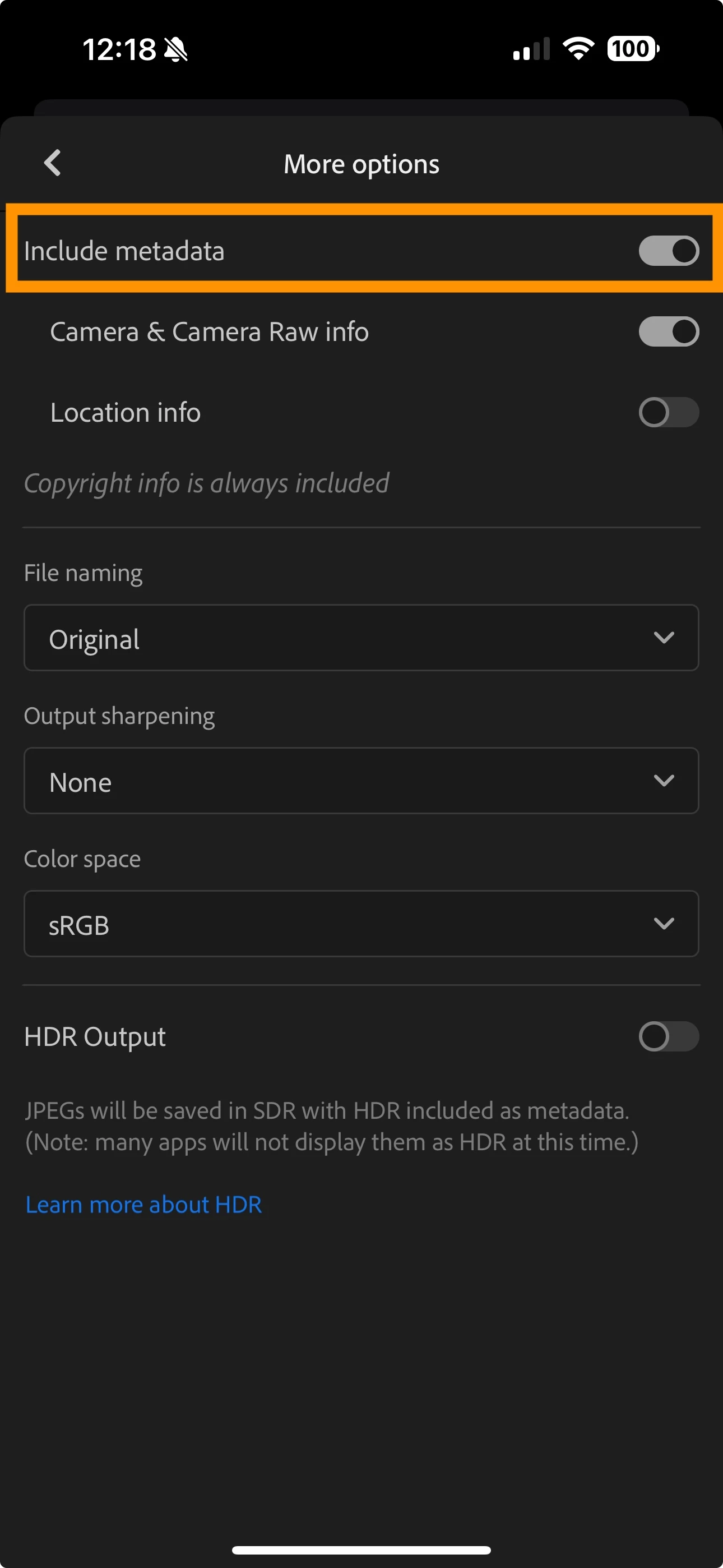

As far as exporting edited versions, the divergent behavior might be due to a design decision.  But I wonder if you could try this.  From the Lr iOS app, when sharing/exporting an edited image, could you try:
Share > Export As.., and under More Options, confirm Include Metadata is enabled?
This menu exposes file options that may differ from the current settings for basic Share, or Save copy to device.  (Default settings for those share methods can be accessed by tapping the toggle button to the right of Share and Save copy to device)
