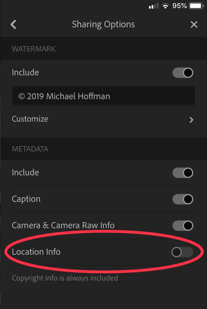

Hi Dadu,
From the grid or album view, go into Settings > Sharing Options and “Enable” the setting to include Location Data. This is off by default. (See below).
This is controls only the export. Photos taken in Lightroom will always have location data (provided you’ve allowed this on your device) and imported photos that already contain location data will have that preserved.
Mike

Thanks, Mike.
Yes, I did have that "Location Info" turn on (see the end of my original post).
It's kind of weird...This was on a new iPhone I just set up (it as working correctly on my older iPhone)...I checked it again this morning after not making any changes (Location Info was still on) and now it's working!
Not quite sure what changed overnight, but there you go!
