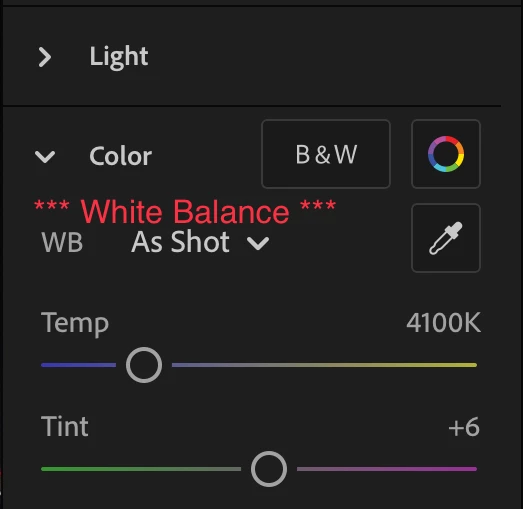

Michael J. Hoffman
June 7, 2019
Could you add some more information here? What you’re describing sounds like what I always do for the ‘Light” section sliders - exposure, highlight, shadows, whites and blacks sliders. But never for white balance (in the “Color” section).
Is it possible when you said “white balance” you meant “whites” which is setting the white exposure level? The white balance sliders are labeled “Temp” and “Tint.”
