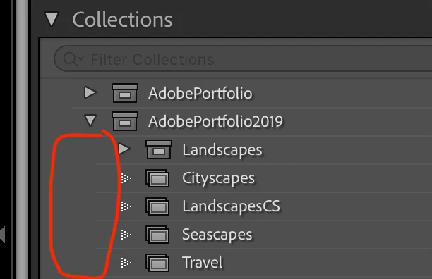

I am trying to create a synced collection that I want to export to Adobe Portfolio. However, even if I am logged on to Creative Cloud I do not see the small 'lightning' icon that can be selected to make any collection a synced collection.
For reference, I have attached the screenshot of how my collections look and I have highlighted the part where I expect the sync icon to see with a red marker (cantsync.png)

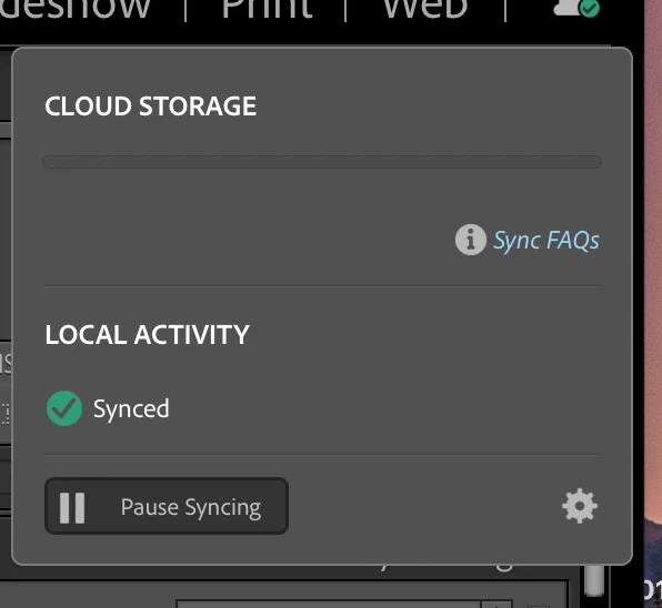

Also, on the top right corner, I see a check mark with the cloud icon. It says everything is synced (cloudsyncstatus.png).

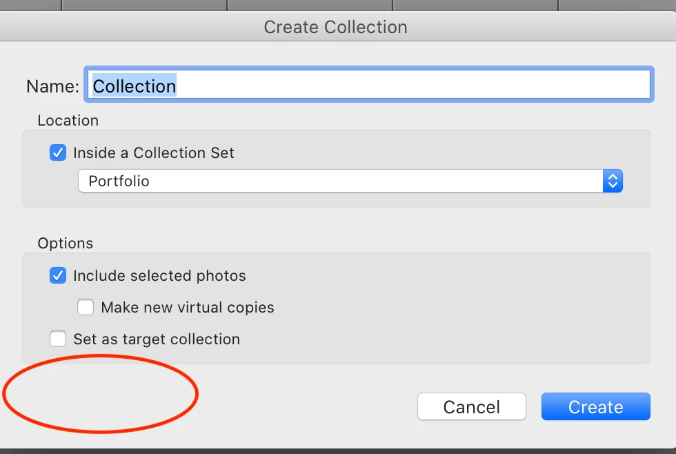

Also, when I try to create a collection, I do not get the check mark which says 'create synced collection'. Please refer to screenshot 'cantcreate.png'.

Although it's probably not relevant, the last screenshot shows you trying to create the new collection in a collection set called Portfolio, but that collection set isn't immediately apparent in the first screenshot.

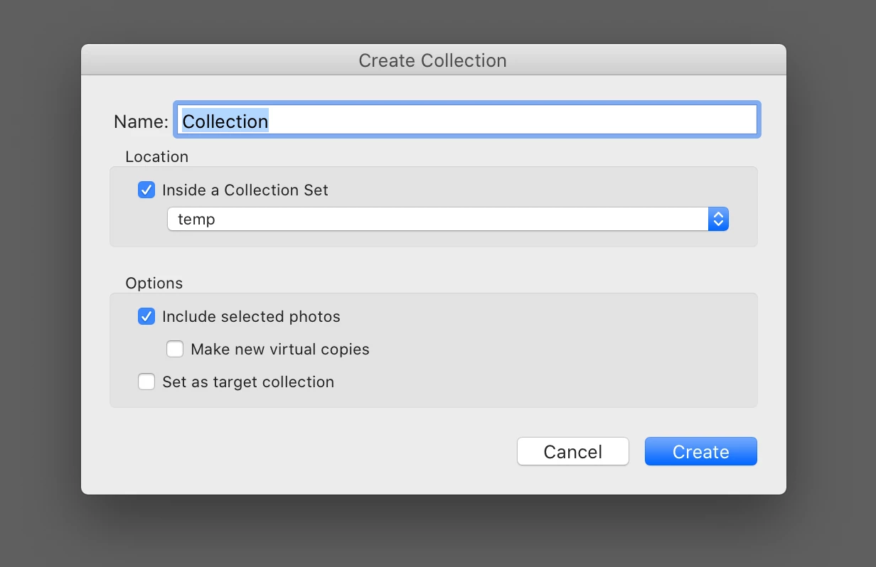

Here, I have a collection set called, 'Temp' and within it, a collection called 'collection1'. The problem is that when creating it, I did not get the 'Create a synced collection option' in the first place. Here is my collection creation dialog:
As you can see, I have all the options except to make it into a synced collection. So I can't create a synced collection.

When you created a new catalog, did you switch it to become the synced catalog (only one catalog can be the active sync catalog at a time). If you didn't, then the ability to sync collections wouldn't be present in the new catalog.  It might be worth trying that, i.e. enable the new catalog to sync, though that will start downloading all your cloud contents into the new catalog, then open the old catalog and re-enable it to sync again. One other thing you could try  first, however, would be to reset the sync data file (you don't lose any cloud content, but it forces LrC to resync with the cloud, after which sync will be paused and you'd need to resume it). It might be enough to prod things back into life again. To reset the sync data, open the Preferences>Lightroom Sync tab, press and hold the Opt key and you'll see the option to "Rebuild Sync Data" appear. Click on that, LrC will close and restart, then the rebuild will occur. When it's finished, resume syncing and see if the problem has corrected itself.
There are some bugs in 10.0 related to collections, so I'm wondering if this is another one. If you can't get it working again (is temporarily rolling back to 9.4 an option?), I suggest you post the details of the problem at the official Adobe feedback site, where you're more likely to get the attention of the engineers: https://feedback.photoshop.com/topics/lightroom-classic/5f5f2093785c1f1e6cc40872

Hi, in this case, 'cityscapes' is not a categories. It is a collection. And it is inside of AdobePortfolio2019 which is a collection set. I have never heard of 'categories' in lightroom, only collections and collection sets. Is there anything that I am missing here ?
Also, I am still not able to create a new collection and set the 'sync to lightroom' check mark on there (cantcreate.png).
