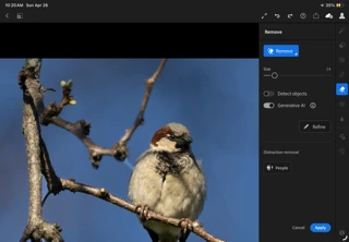

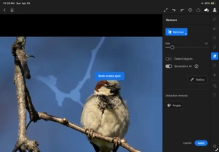

Phantom imaging appearing after using the remove tool
After using the remove tool with generative AI selected a bright phantom image appears rendering the tool useless. Photo as attached as an example.

    You need to update your sky mask. That mask did not include the branch you now removed, so the removal created a gap in the sky mask in the shape of the branch. Updating the mask solves this.
