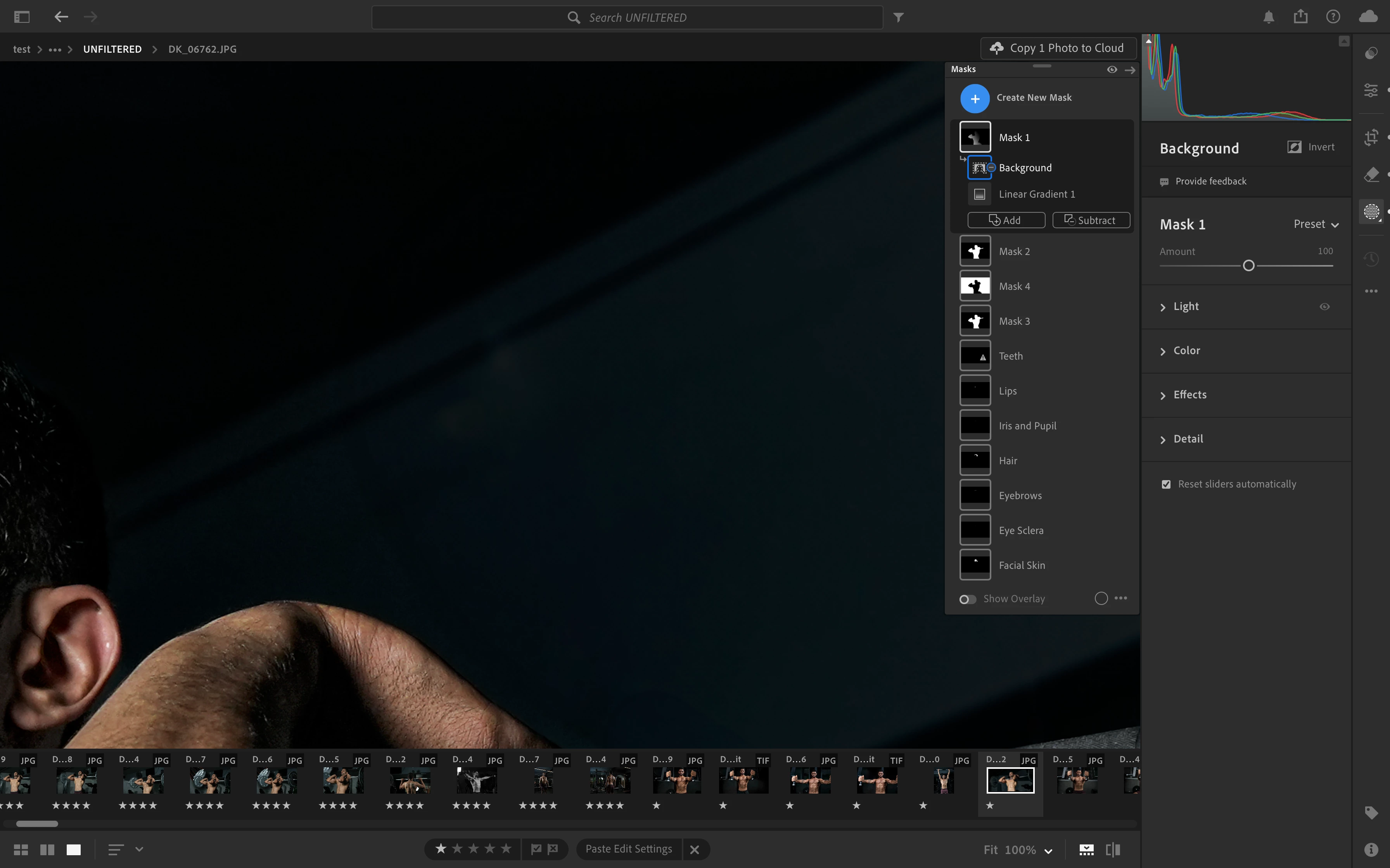

Did you use a sky mask? If Lightroom creates a sky mask, and there is an object in the sky, then that object is not selected as sky, so it will be a gap in the mask. If you then remove that object, the gap in the mask is still preset and causes this strange ghost object. The solution is simple: you need to update the mask.

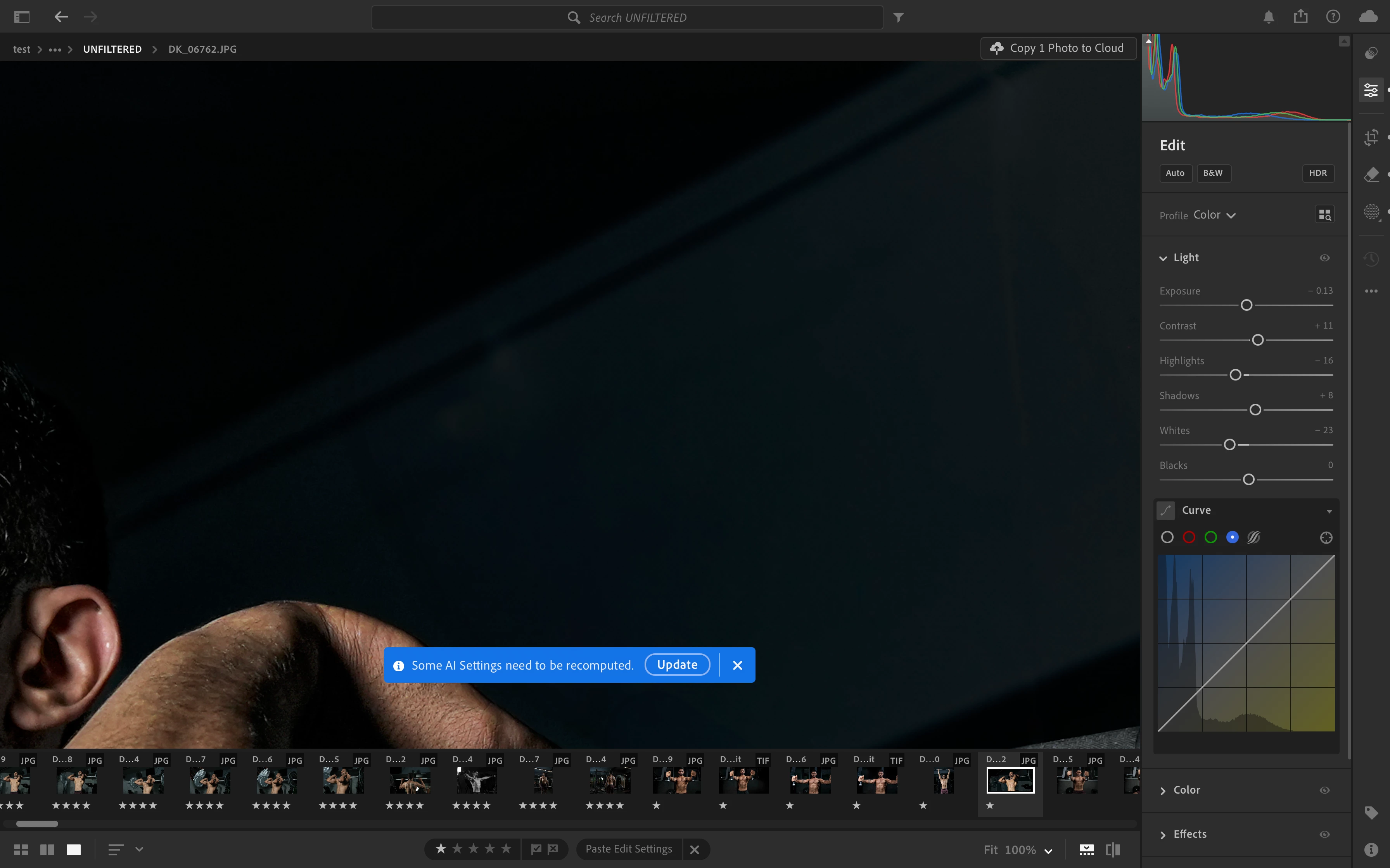

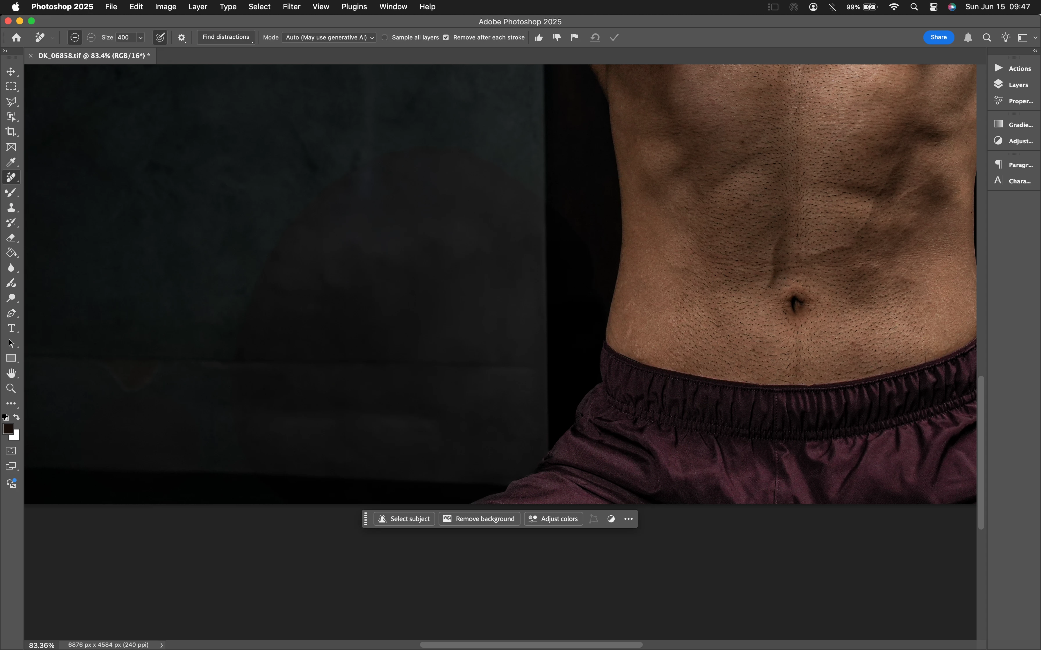

Jun 15, 2025 4:23 AM UTC
i do not think that is just it. I was even guessing it might be cuz of some masks i had left. Nope, it is a technical issue. This had been happening since a long time and I had been ignoring. it is frustrating.
