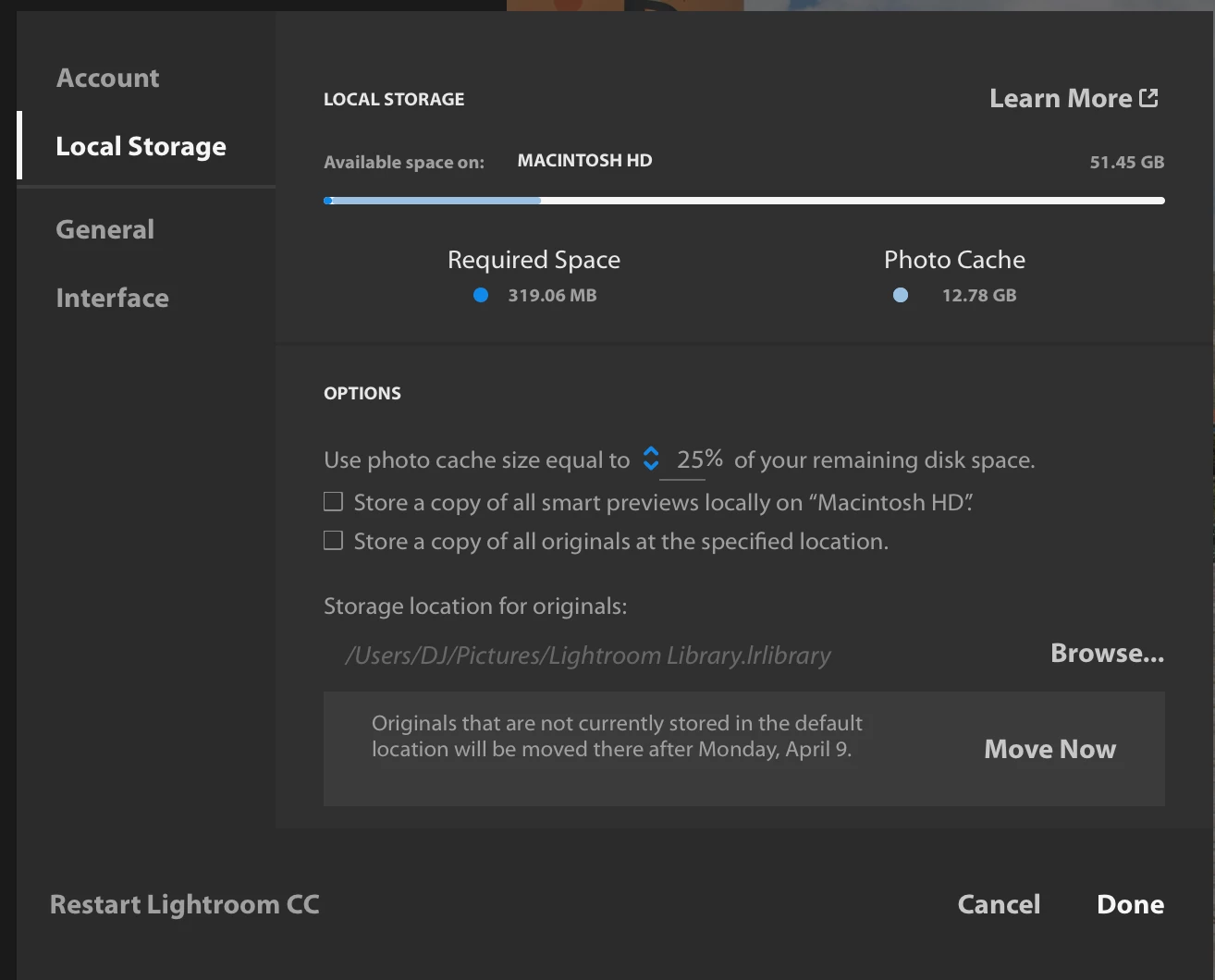

    I thought the option of storing an original or a smart preview meant that if you didn't check those boxes [under SYNC Cloud (upper right corner), Setup up wheel (lower right corner), then Local Storage], then LR wouldn't store on your local device. Wasn't the whole idea of LR CC was to stop filling up our hard drives with images and get them into the cloud where we would access the photo from different devices?
    After uploading photos via my LR phone app, I can see the photos on LR CC on my laptop, but I can't see where copies are stored on my laptop. Is there a preview cache somewhere?
    Now, as soon as I open LR Classic, I see the images sync and begin to download to my laptop.  The images get stored in a file called Mobile Downloads.Irdata in a folder with a long file name. They weren't in there when I opened LR CC, only after I opened LR Classic.
    So, are there TWO sets of images on my laptop, one for LR Classic and one for LR CC? If so, that's a lot of data taking up storage space.
