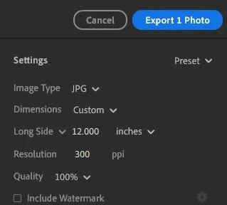

If you insist on having a specific PPI recorded in the exported image metadata, then the process in Lightroom requires you to decide the pixel dimensions you want by specifying PPI and INCHES -

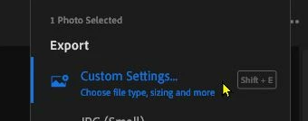

1)  Export with CUSTOM SETTINGS
2) In the 'Settings'-
Set [Dimensions] to Custom
Set [Resolution] to 300,   or whatever PPI you want.
Set [Long Side] for the desired size of the exported file in INCHES.
(eg. 12inches at 300ppi  exports a file that is  3600pixels long edge)
(eg. 20inches at 300ppi  exports a file that is  6000pixels long edge)
The resulting file that you export will be as per your settings- (My JPG example 12in @300ppi)
