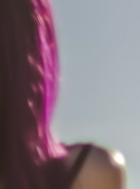

Hey guys,
I'm done with editing my photo and noticed this hard edge in the hair of the model (made the photo with f1.8 so don't wonder about the blurry look). How can I delete it WITHOUT Photoshop, just with Lightroom? And how could this happen? Which setting caused this?
Sorry for my poor english, I'm from Germany.
Correct answer Jao vdL
The purple hair with the color missing at the edge gave me the hint as I've run into this exact situation myself. Unfortunately you can't do much about that. You can brush away the defringe using the brush with negative defringe values in areas where you see a problem like this or refrain from using the defringe andbrusihing in a positive defringe in the few areas where you have objectionable fringes. My experience is that I only see objectionable fringes using certain (large aperture) lenses and in high contrast edges so it becomes a lens choice thing. I rarely use the defringe anymore nowadays as most of the lenses I use have it very well controlled.

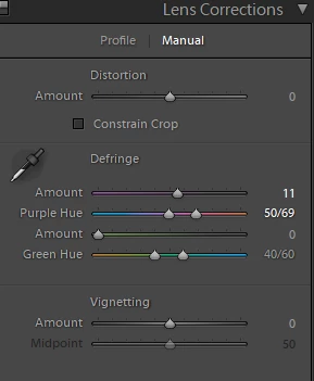

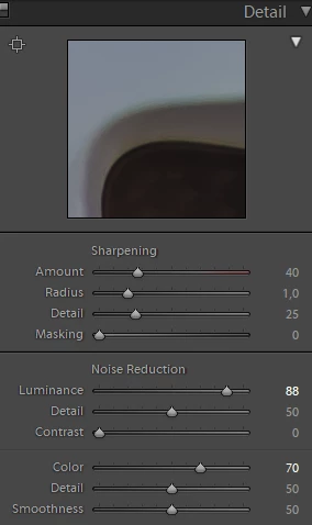

Looks like a result of defringing in the detail section or excessive color noise reduction. Can you show a screenshot of your detail settings. Make sure the defringe section is expanded. If you are using Classic instead of Lightroom cloud, show the detail and the lens correction section with the manual tab selected where defringe lives.
The lighter halo could also be an effect of coma flare in your lens which cannot be corrected but it likely is oversharpening.
June 6, 2020
It's so amazing how you found the solution just because of looking at the screenshot. Very impressive. Have still so much to learn...
Here are my settings (I hope the screenshots are OK):

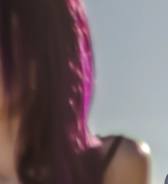

And this is the part of the photo when I undone the Defringe settings:
It's damn hard to defringe when the model has purple hair... Maybe you have some tips?
Jao vdLCommunity ExpertCorrect answer
June 6, 2020
