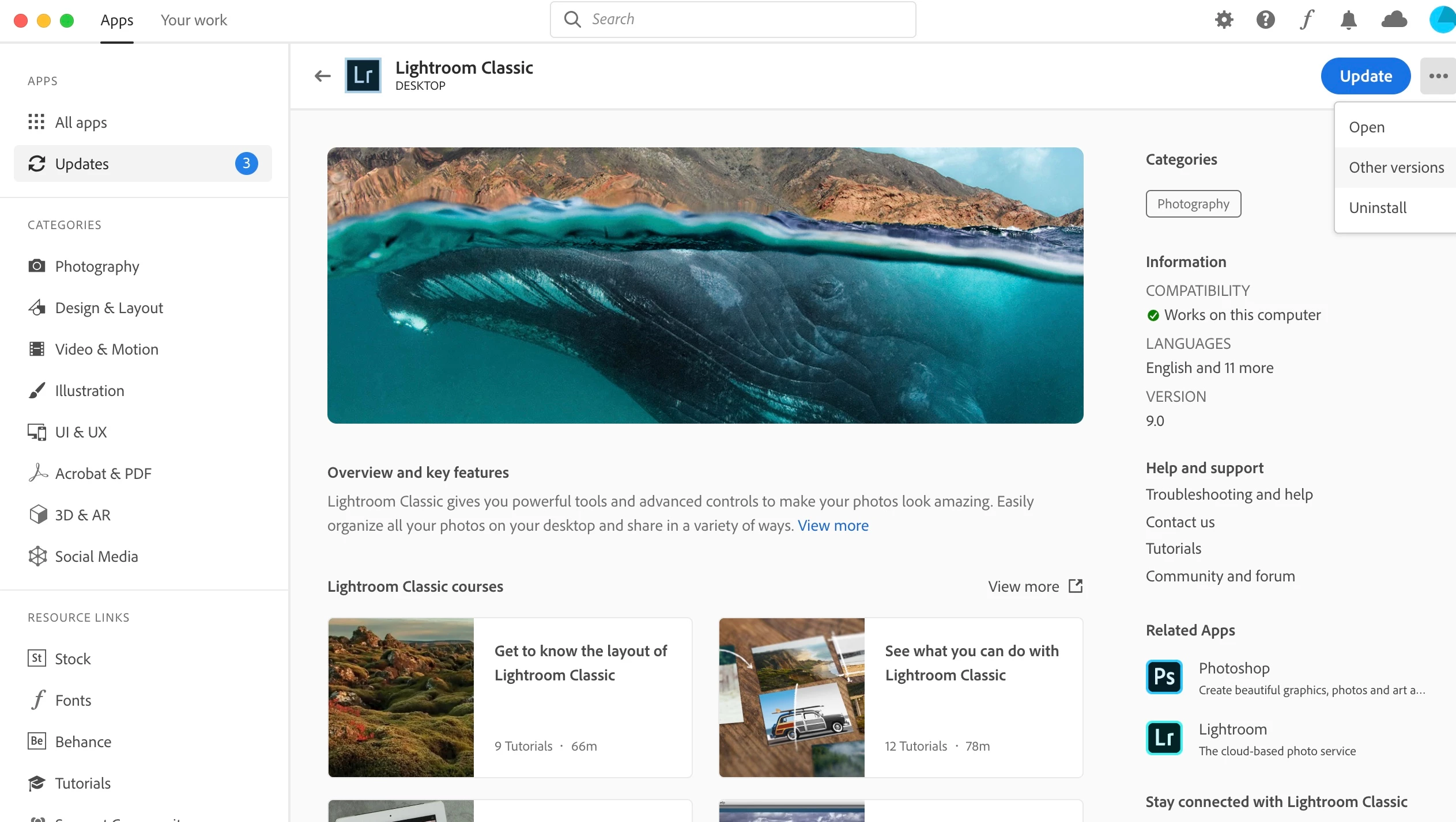

I first went into my creative cloud which looks like this

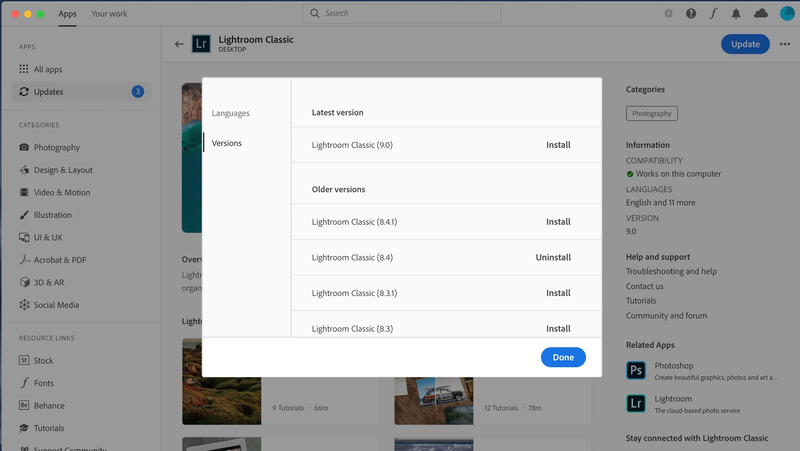

In the upper righthand corner, I selected the three dots ...
I then selected to install a previous version that had worked for me. After re-installing it, I went back and  uninstalled the newest version.

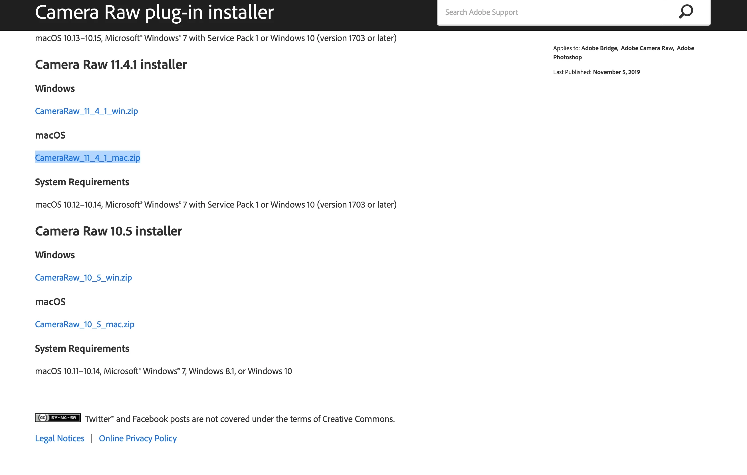

Lastly, I went to adobes link for camera raw https://helpx.adobe.com/camera-raw/kb/camera-raw-plug-in-installer.html downloaded and installed Camera Raw Version 11.4.1 which ultimately fixed my problem.
