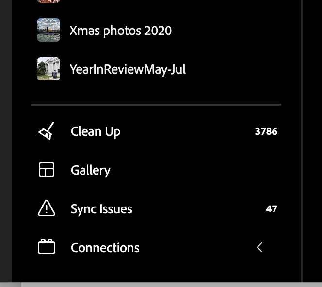

    One thing: How/where shall I “look at Sync Issues”..? what do you mean by that?
    Aug 5, 2026 4:52 PM UTC
    In Lightroom Web, scroll to the bottom of your albums and you will see additional views.  If you have problems with files that are partially synced, you will see an item called “Sync Issues” as I am showing here:
