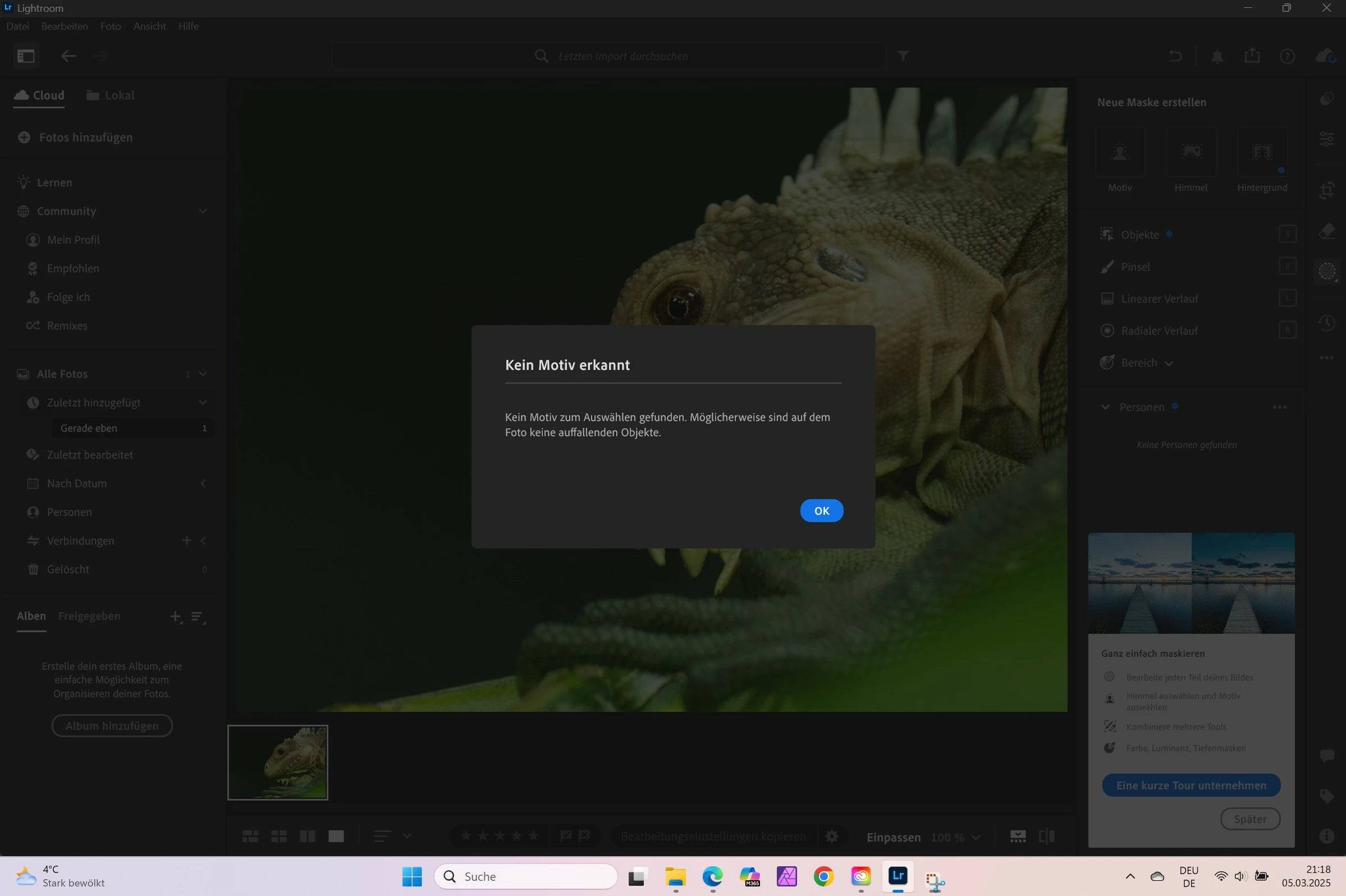

For a few days now, the subject recognition in Lightroom has no longer worked. Most of the time, no motive is recognized at all or sometimes something completely wrong.

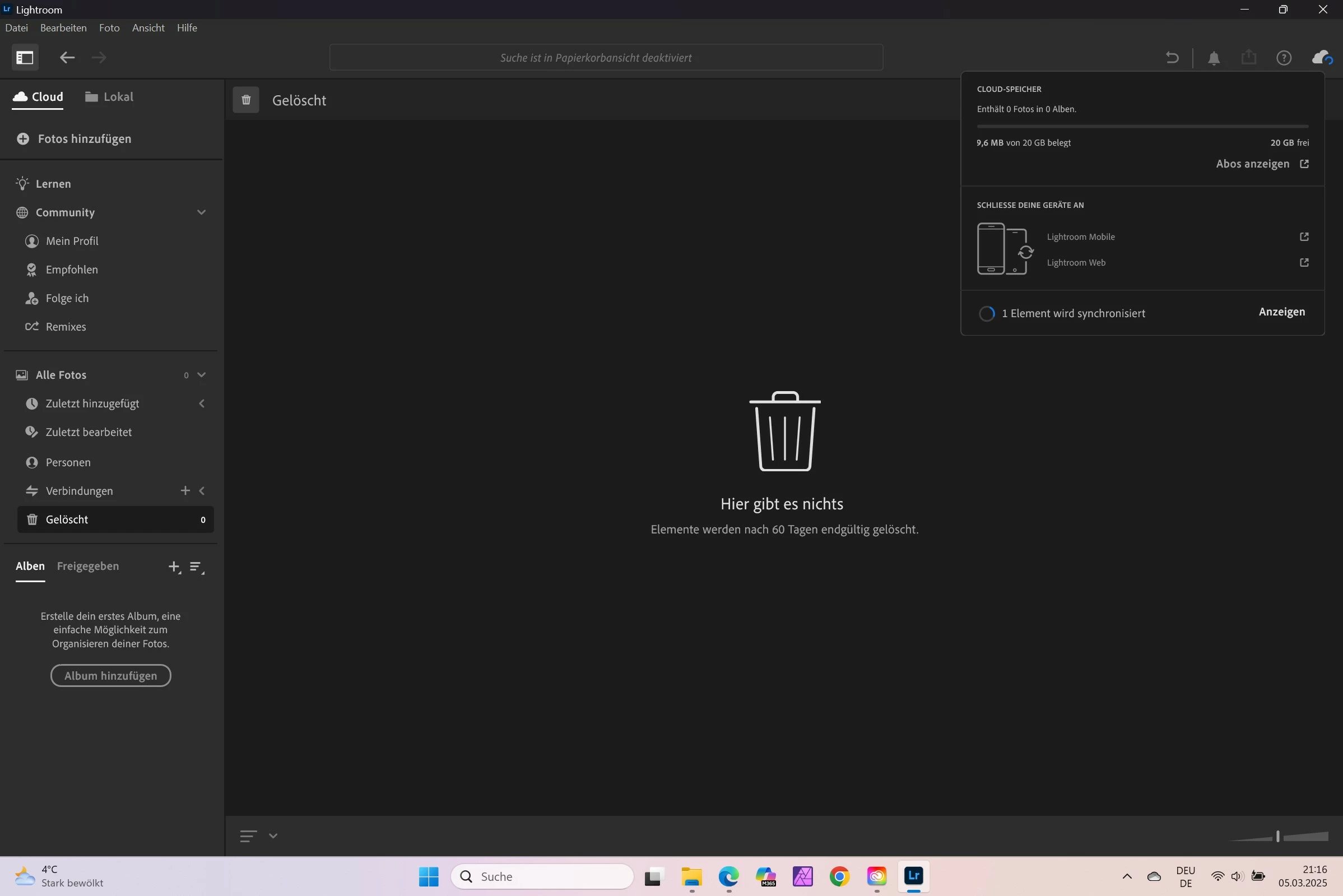

In addition, something hangs in the synchronization - possibly a connection ?

unplugged all devices including wireless mouse - same problem
i've already tried with images where I used this function before without any problems
GPU-driver is latest revision
tried subject recognition on camera raw - there it is working without any problem
I dont know when the problem has started. It was working 2 or 3 weeks ago.
still there is this synchronising issue (ive already tried differnt things mentioned in the help)
