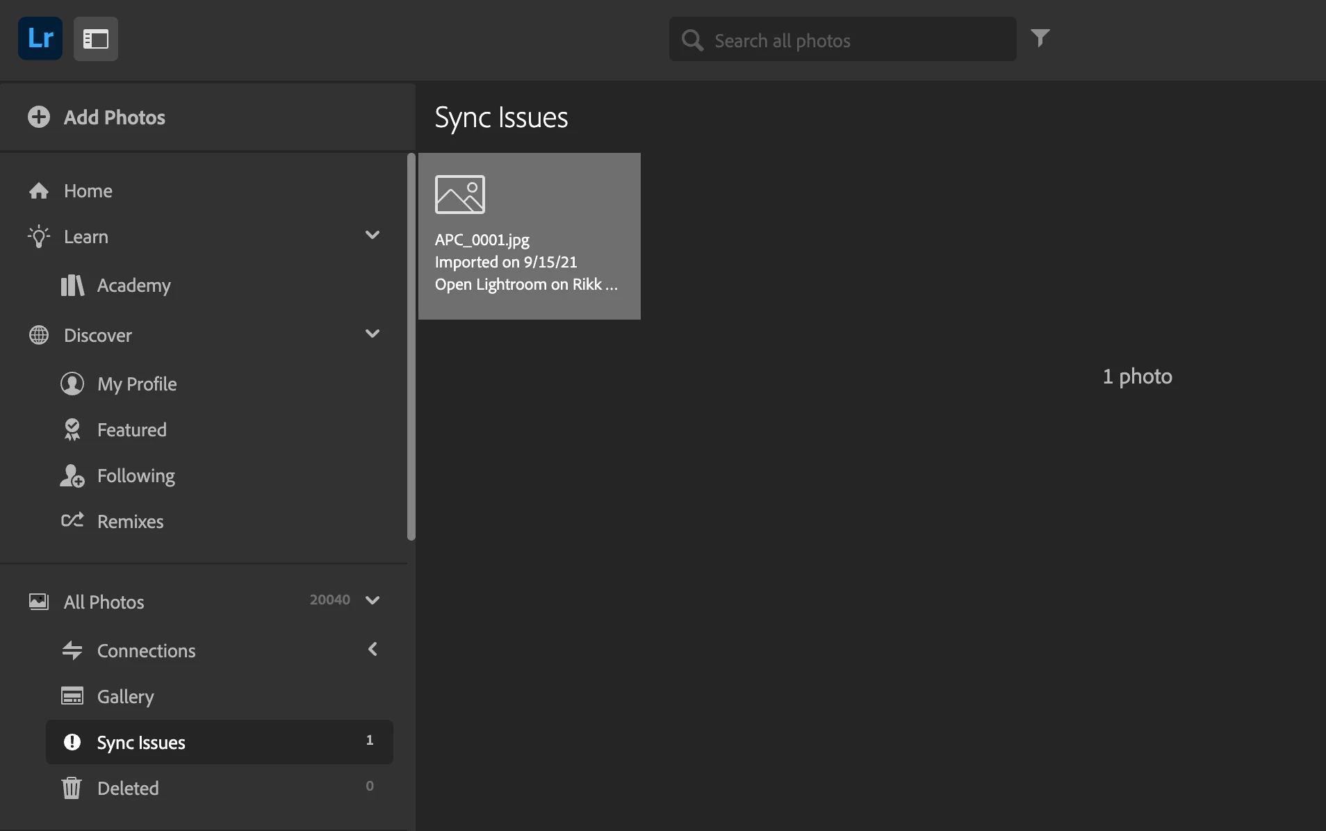

Generally, when this error occurs, it is advisable to go to lightroom.adobe.com and look for a Sync Issues folder.
 The thumbnail will usually identify the offending surface and allow you to attempt recovery from that device.

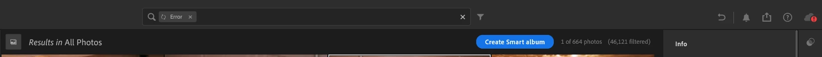

The following screenshot displays the error message that I see.
When I goto  lightroom.adobe.com and look for a Sync Issues folder, it is empty.

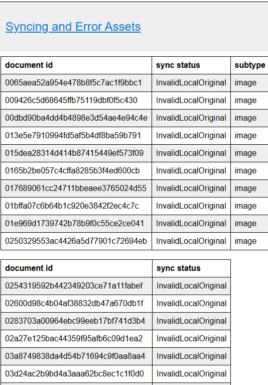

I went to Preferences and ran the Sync Issues report. I see lots of the following errors in that report.
