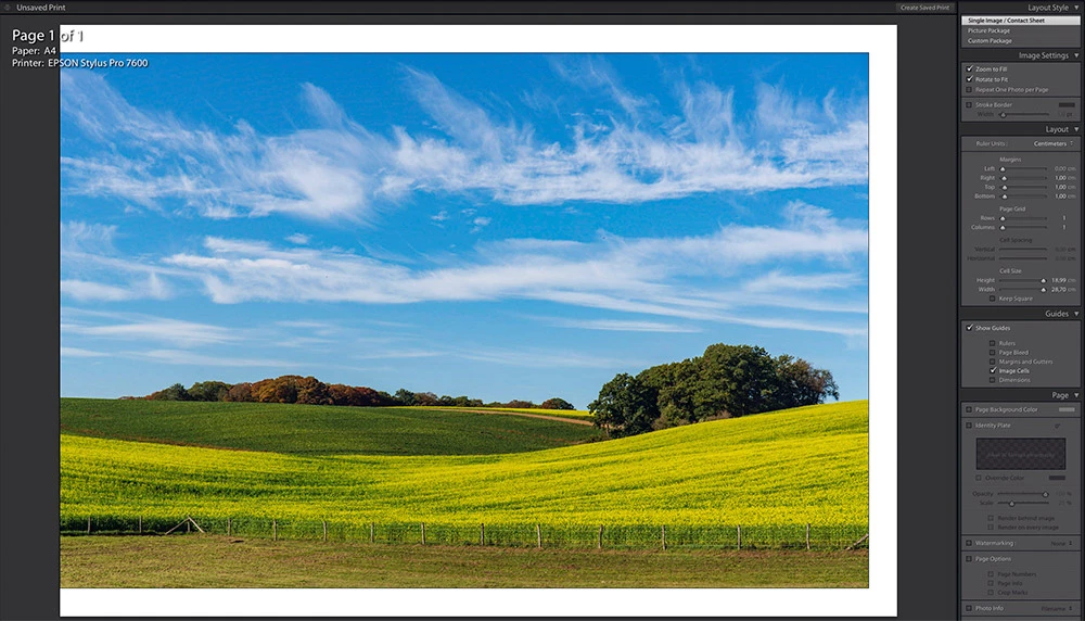

    Perhaps the problem is this. Some printers need a bit of extra paper margin to hold it. For my Epson Stylus Pro 7600 I created a preset that looks like this, so no margin at the left side. When I print using this layout, the final print has a perfect edge on all sides.
