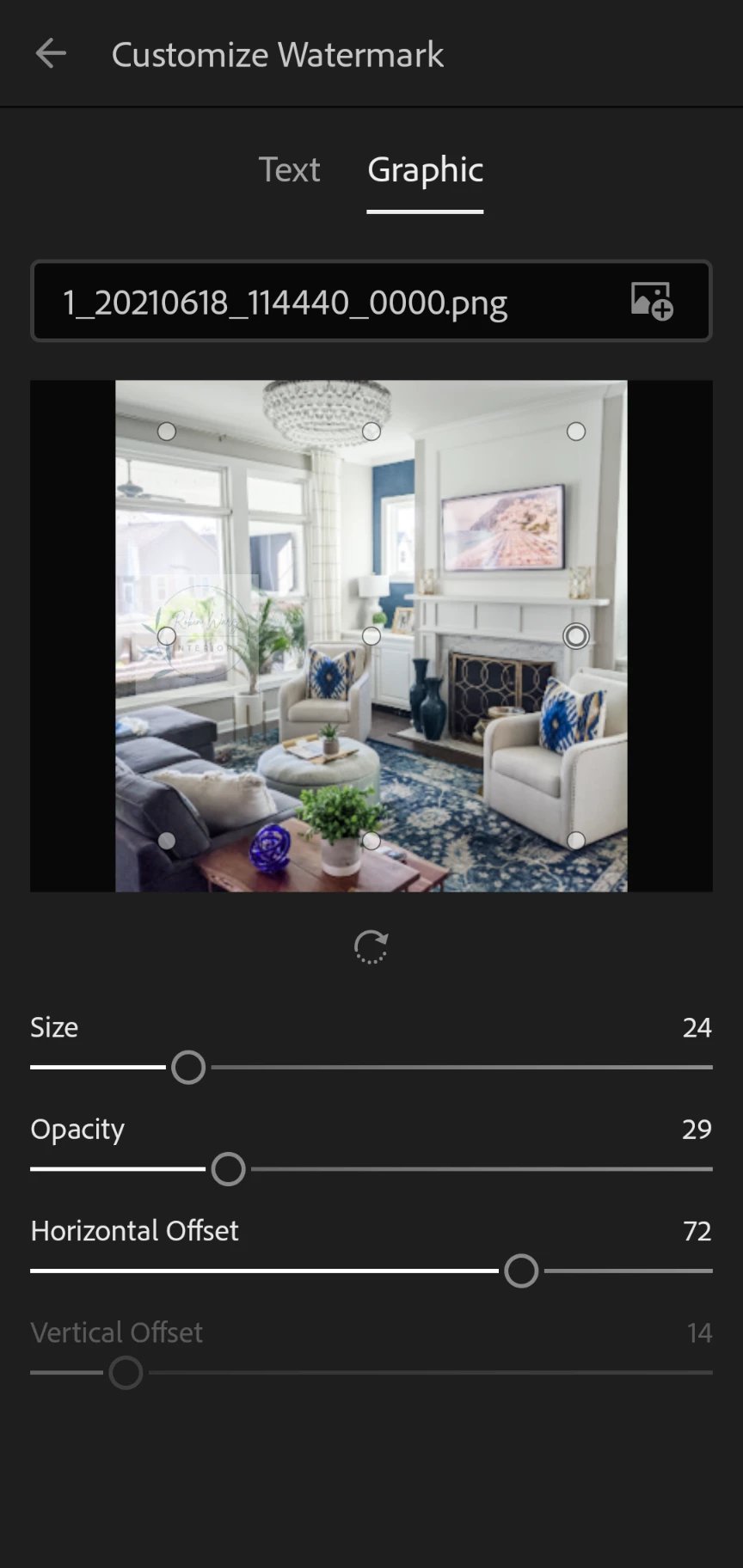

Hi Folks! I am hoping that you can help me. I used to be able to change the vertical offset of my watermarks on Lightroom mobile, but now this option is grayed out and I can only move the watermark horizontally. Please help as the watermark is positioned in the middle of my photos which is not ideal. For reference, I am working from an Android.

When you have one of the middle pins on the side selected, the Vertical Offset slider is not available.  (Likewise, when you have one of the middle pins on the top or bottom selected, the Horizontal Offset slider is not available.)  To enable the Vertical Offset slider, select one of the pins at the top or the bottom.

Thank you so much!!!!

I don't use Watermarks but if you tap of some of the dots on the preview, does the vertical become ungreyed?
