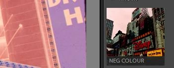

You should just be able to use the LUT you mention directly in Camera RAW to create a profile that you can use in Lightroom. I do think you might still have to deal with the sliders working opposite to what you expect though. Wobertc posted some links on how this works. I have used these to create film simulation profiles from LUTs I use for video work. It is not hard to do but it has some limitations.

2) You can make a Profile in ACR that reverses the tone curve and use LUTs, and then use as a Profile in Lightroom.
The Profile in Lr does not reverse the tone curve in Lr or change the Basic sliders, but it does reverse the action of many of the Basic sliders. ie. The remaining problem that no one seems to be able to answer with raw files.
