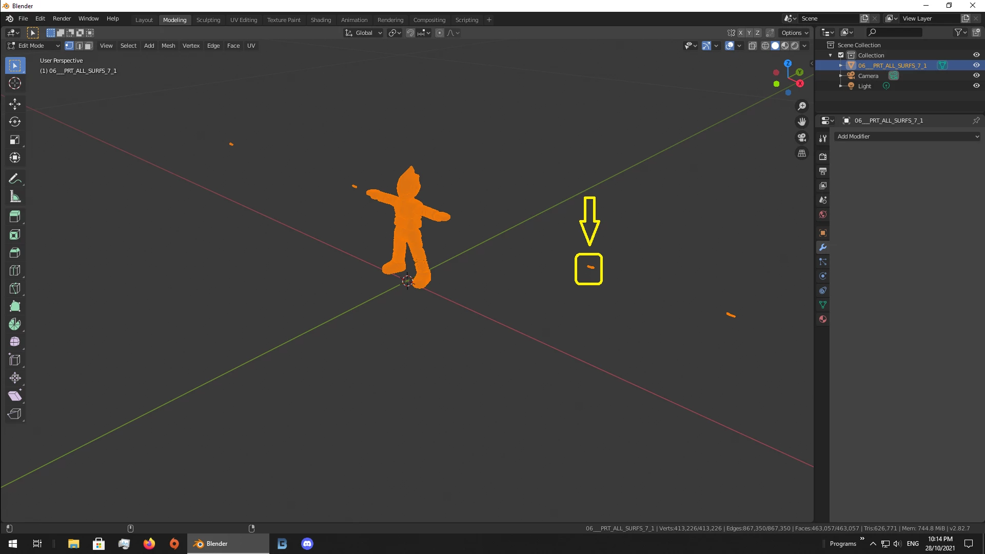

Hello, my model was successfully uploaded to the website, but there was an error in the website mentioning when the animation was generated. What is the reason?
I can't find the reason, please reply me

the error you get will be a general one that means your model does not fit the rules
Cinema4D has a few issues trying to make correct files... start by removing the parts floating about then think about dropping the file size down to under 20 and that thumb tucked under the hand means you can't add figures

the same issues as before + the complex internal structure = I'd use Iclone instead but if you have to use Mixamo then I recommend wraping it as the best option
