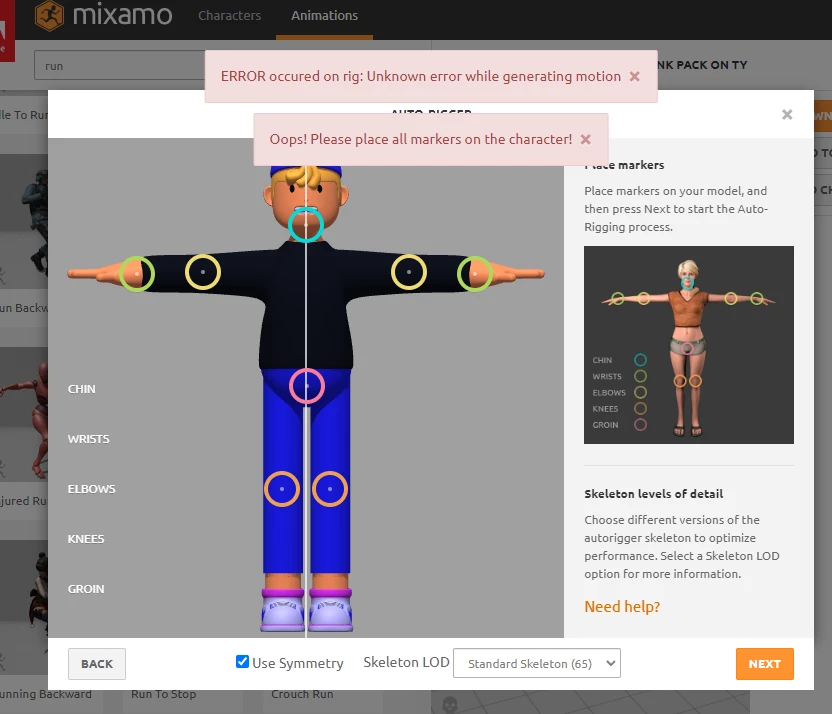

ERROR on Rig - Unknown Error while generating motion
I have tried too many times, and everytime i get this error.
I have tried with diffrent models, removed stuff from the models, i have tried with and without bones, and I have even tried in diffrent browser nothing seems works.  I cant uploed my "own" models. Please help

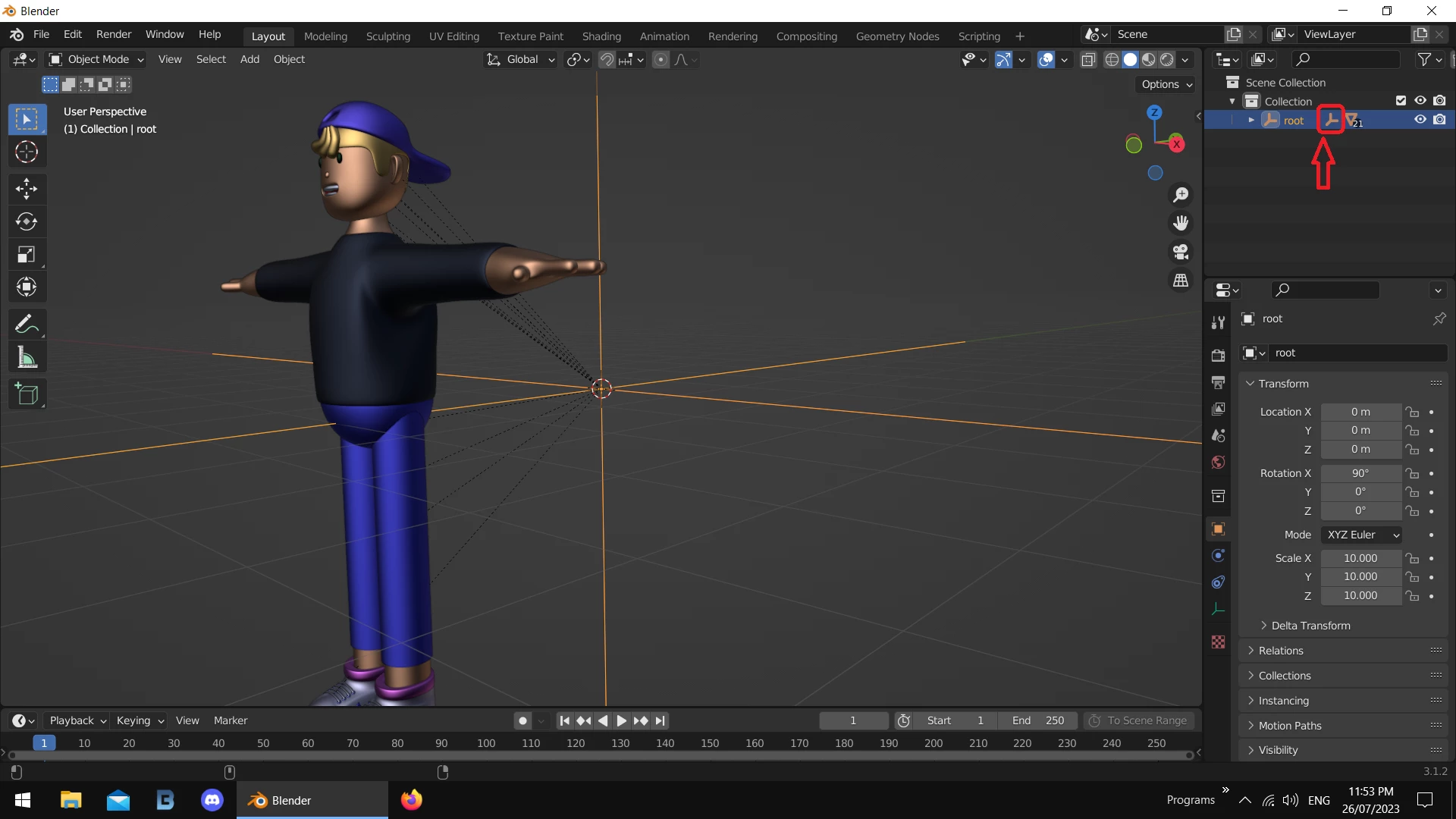

warning: this is in the upper limit of what is possible with Mixamo... i'd cut the model down by 1/2 if thats possible but its your project

Jul 27, 2023 6:46 AM UTC
the reason it wont rig is the same reason its so big a file... all of those nols act as bones and Mixamo can't read them because its not a standard file type
