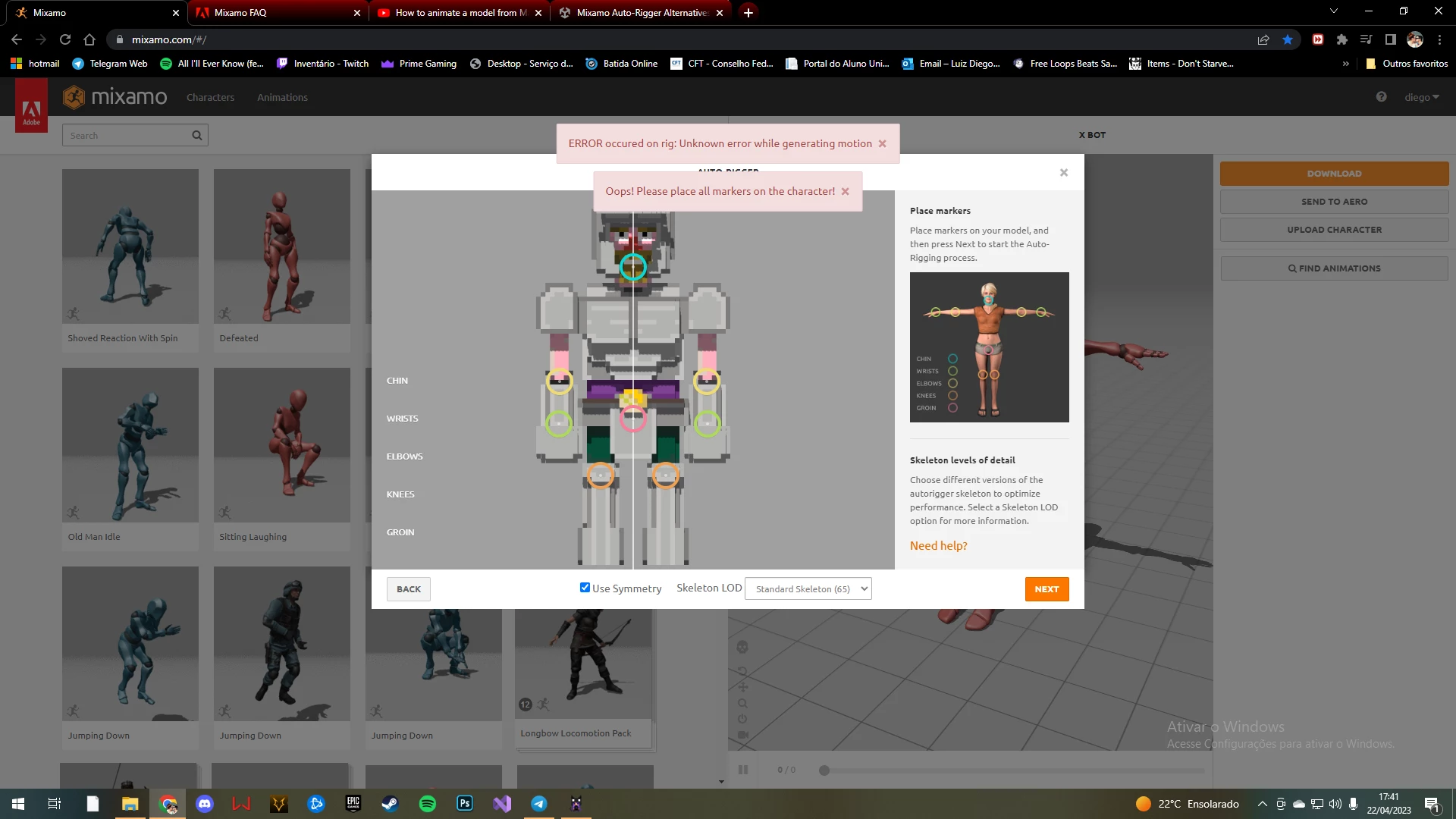

it will be cause of the arms... try putting him in Tpose and that should work
[otherwise share the model}

diego295399556ztr
Apr 22, 2023 10:28 PM UTC
Living and learning! The Tpose solved the riddle, much thank you!
Best wishes!
diego295399556ztr
Apr 22, 2023 8:52 PM UTC
I've tryed the NO FINGERS skeleton but the error still in there!
x.x
