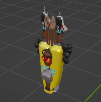

i want model with all rotation to zero, but recently download model all with rotation. if i reset all these transformation to zero, the leg will up. please help. thank so much.
after reset transformation

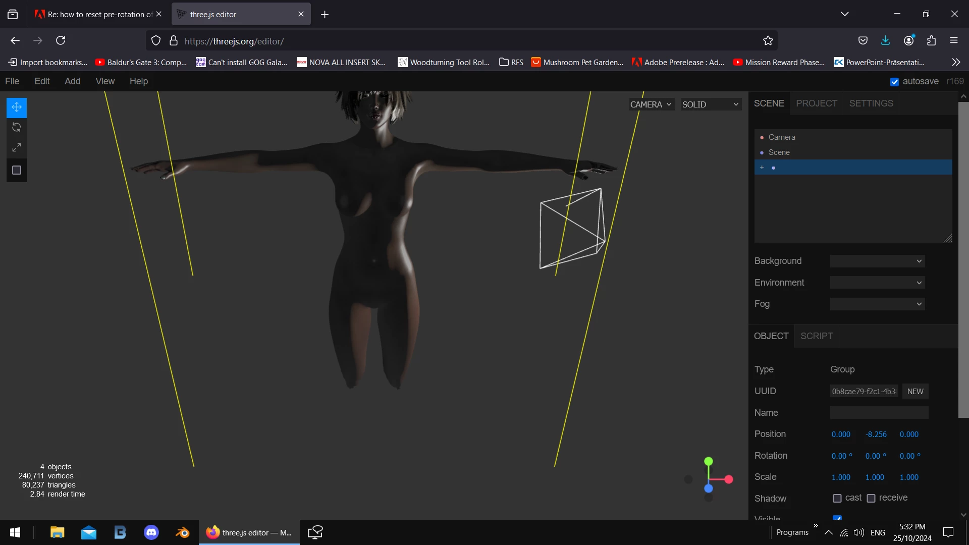

1 thats not true... threejs can import Fbx without any bones, rotated or otherwise
example: this Mixamo model has had custom hair added then converted to the old [1974] Fbx standard which loads in both Blender or 3js

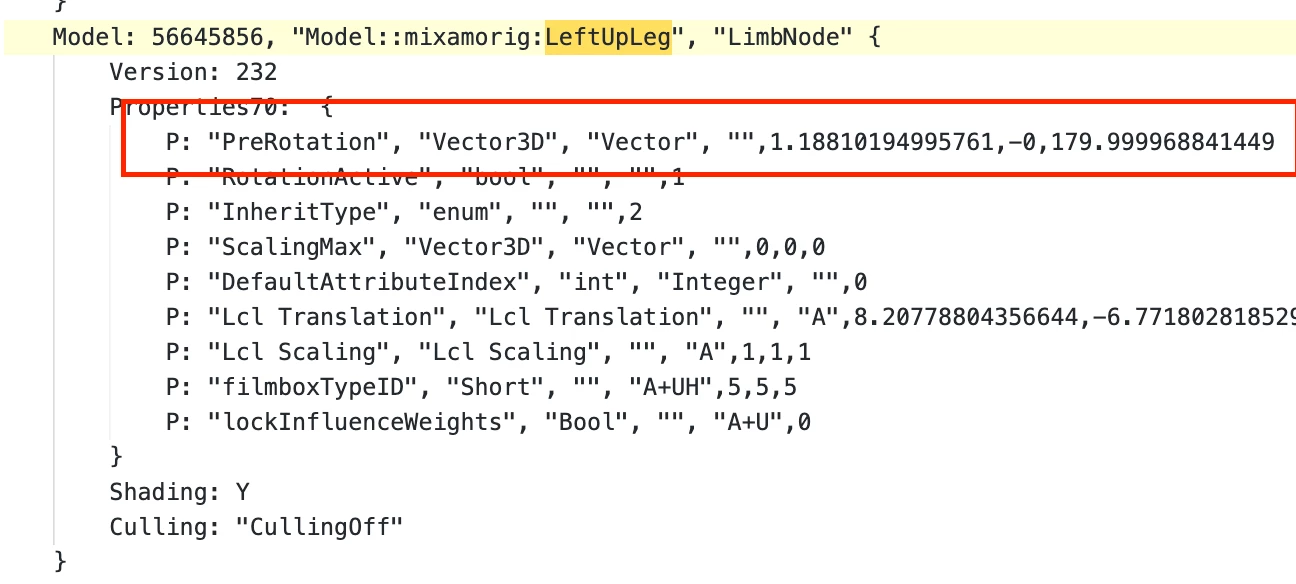

1.I'm using threejs to display model with pose. threejs has no method to apply pose or load model with no init bone rotation.
2.I have every bone with calculated rotation, need to rotation to every bone. so the pose can show on web. If i done this, anyone can use the model they like generated by mixamo.

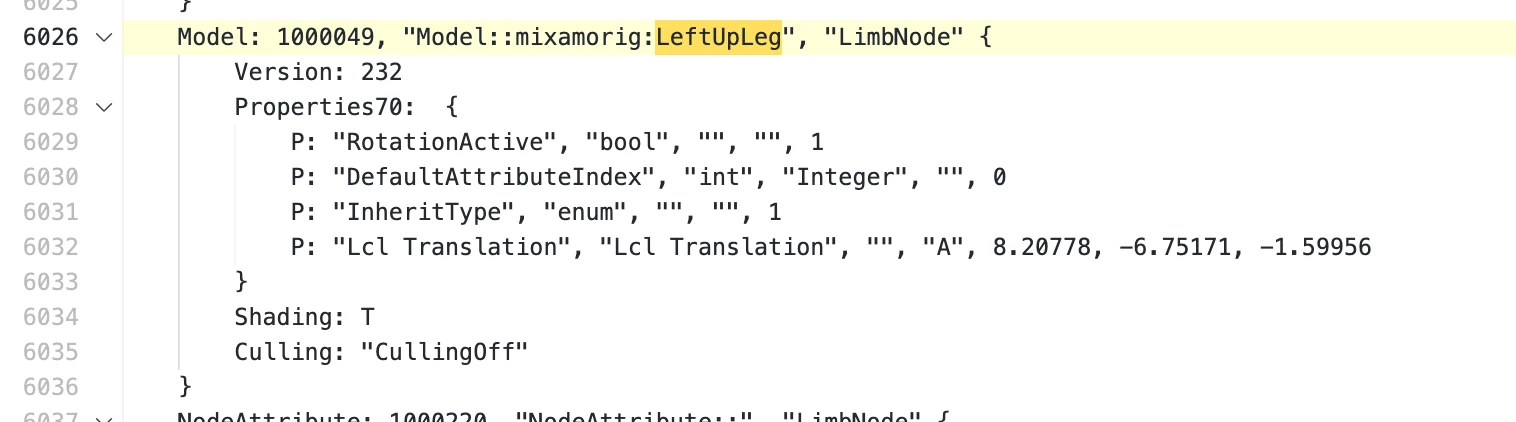

I have some old models download on mixamo, the model has no rotation so i can pose it successfully.
please download xbot-ok-ascii.fbx for no rotation model and marker_man_rotated_ascii.fbx for recently downloaded with bone rotated. sorry for upload it failed. The below picture show old xbot model download from mixamo with no rotation.
