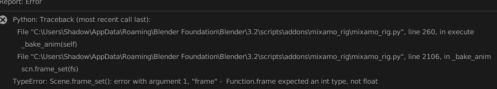

I have a problem trying to combine animation from mixamo, I did everything,  my character get all the actions in the NLA but at the moment of running the button "baked animation" in the mixamo addons I get a python error... I know that this problem happened to others but since 3h I can't find how to fix it... maybe there is an issue with the code itself (int type vs float) ? i d'ont know...
I'm on blender 3.2 and I have the last version of the add-on (downoalded today)...
there is the error :
if you could help me, it would be amazing ! thank you for reading me 🙂

Did you figure it out, its driving me crazy as well - I updated blender to 3.3 still the same python error when I try to bake the animation (int typte, not float)

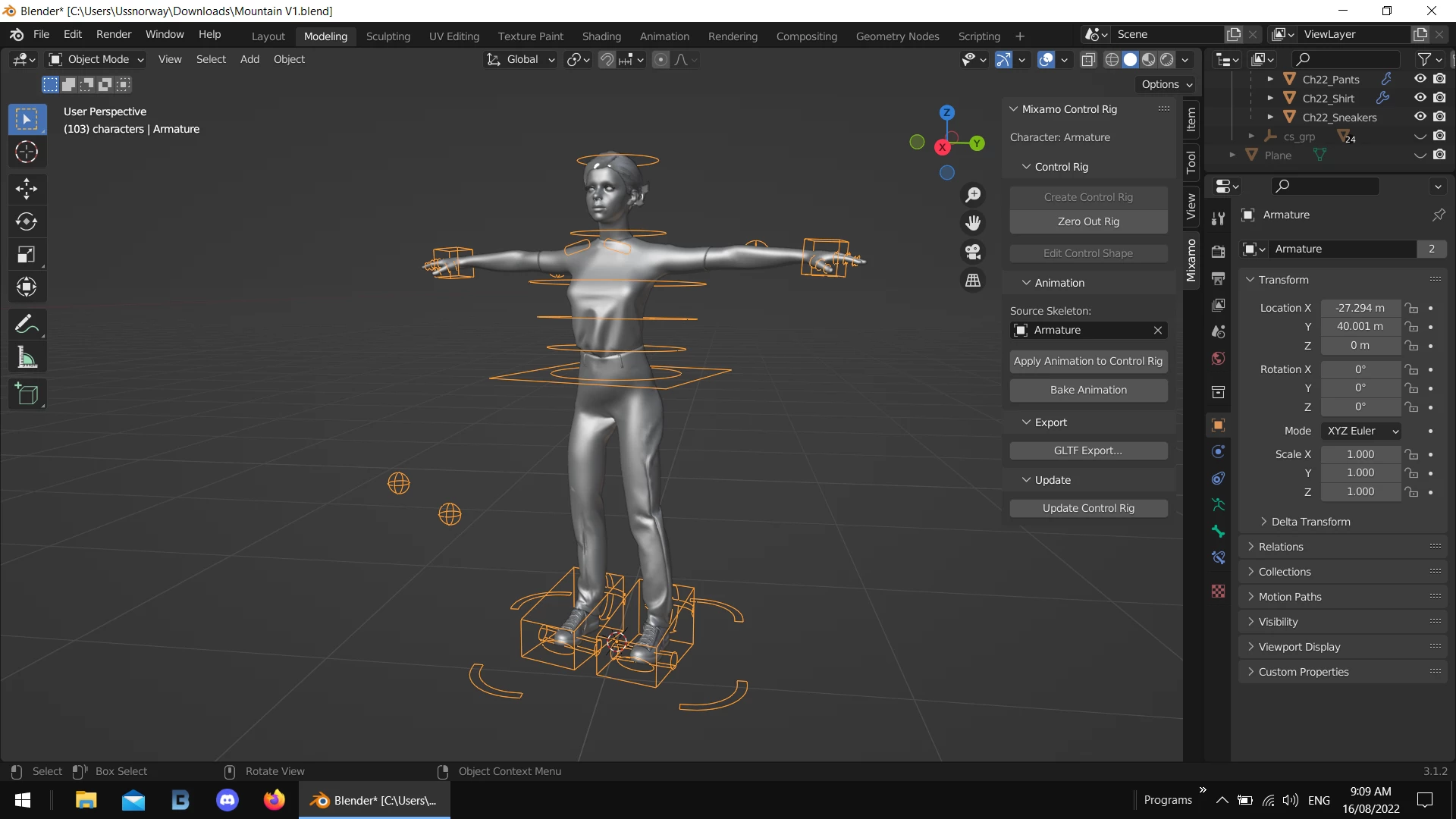

i asked you for the model not a blender file
i don't get a script error at my end on Blender 3.1.2 but there is a lot of groin distortion when zeroed out... i assume that is a carry over from the base model however you didn't include it so i can't test
i conclude the error is somewhere in your workflow [prob the base model]

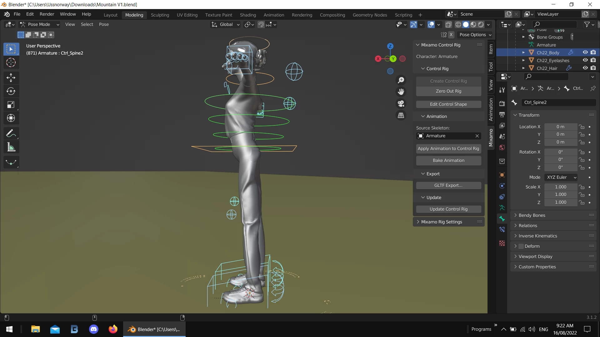

then yes it will be the base model... they have very different bone rigs and you should reset each model you want to use the same rig
