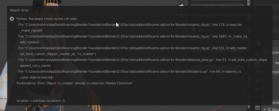

Mixamo Blender Addon can't create control rig in 2.93
So I got the Mixamo addon installed in Blender 2.93. But somehow it can't create the control rig. It just spits out an error.
Though, the addon does work in 2.92. I'm guessing that it's because the addon was made in 2.92 or below.

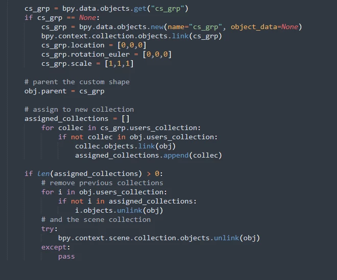

Endertainer007
Jul 30, 2021 3:57 AM UTC
Ok. So I add it. But now the addon won't show up.
Here's how the code looks:

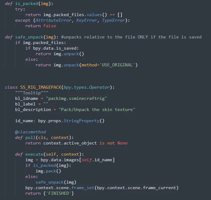

Endertainer007
Jul 30, 2021 3:59 AM UTC
Oops, sorry. Wrong picture.
