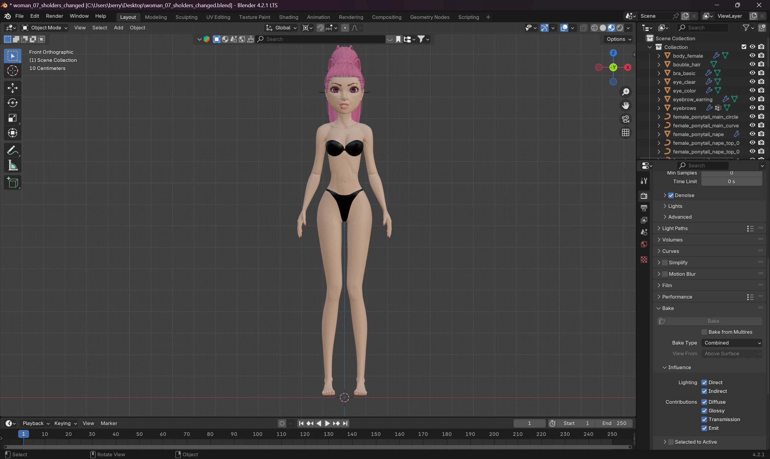

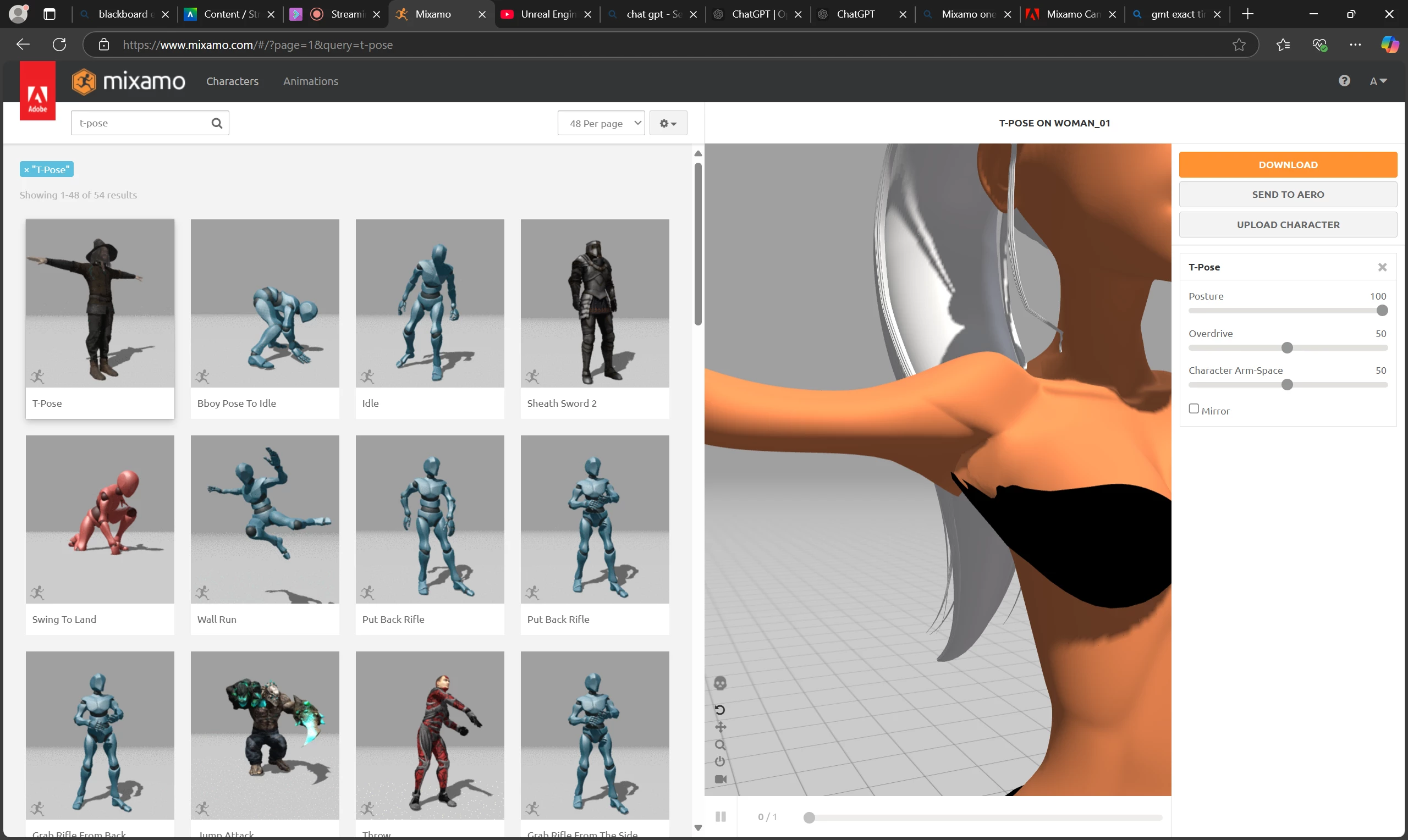

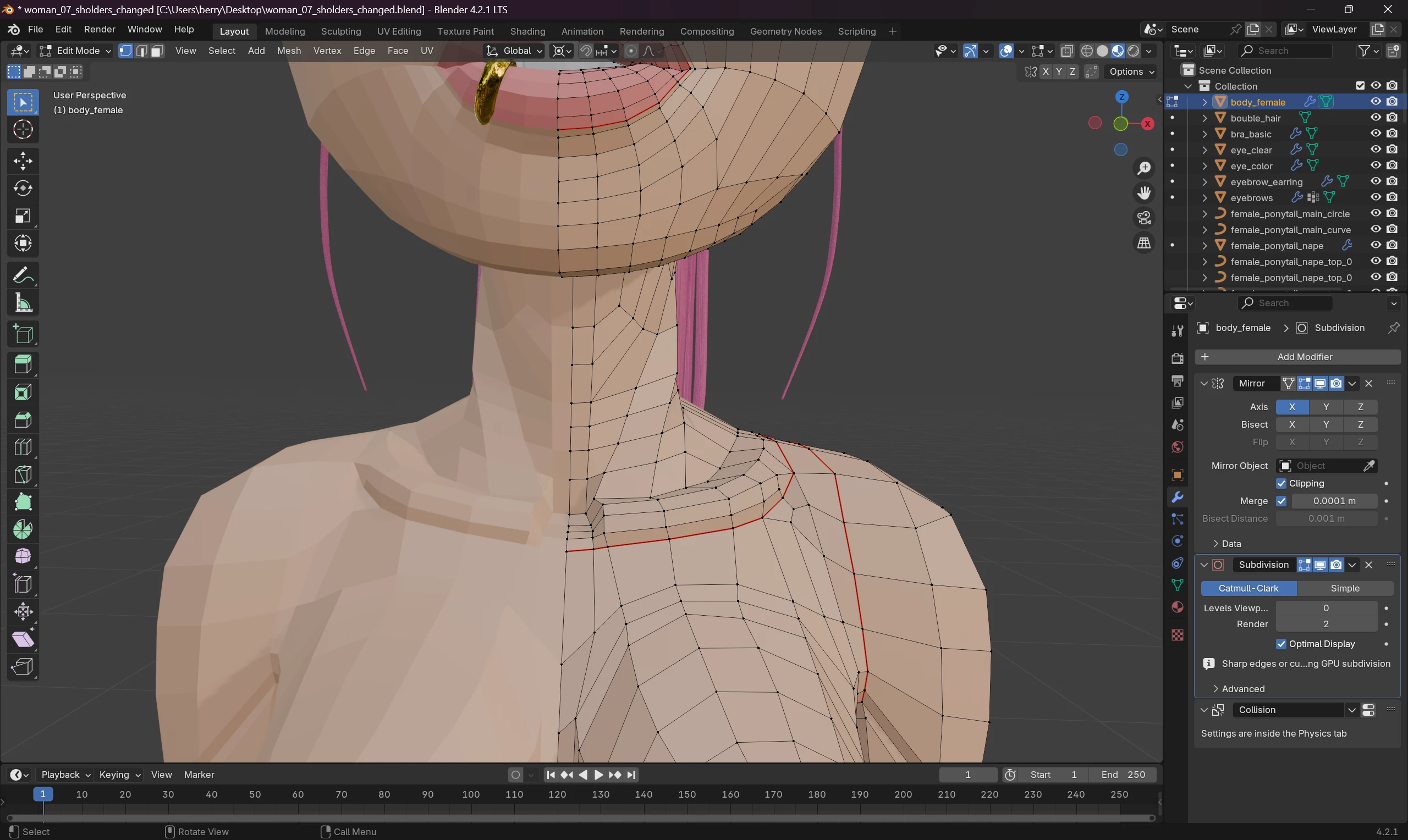

Hi, I have the same problem. My model was created in Blender using the mirror modifier, so it's symmetrical. However, in Mixamo, the T-pose looks wrong, with one shoulder getting deformed. Other animations look fine or have only minor deformations. I've tried both applying and not applying the modifiers, but it doesn't make a difference. I also tried uploading just the body mesh by itself, but I still get one side that’s off. I've attempted to adjust the shoulders, but it always results in asymmetry. When i made a T-pose myself, all of the animations looked wrong the shoulders were kind of too low. Does anyone know a solution? How should the shoulders be modified to achieve symmetrical results in Mixamo?

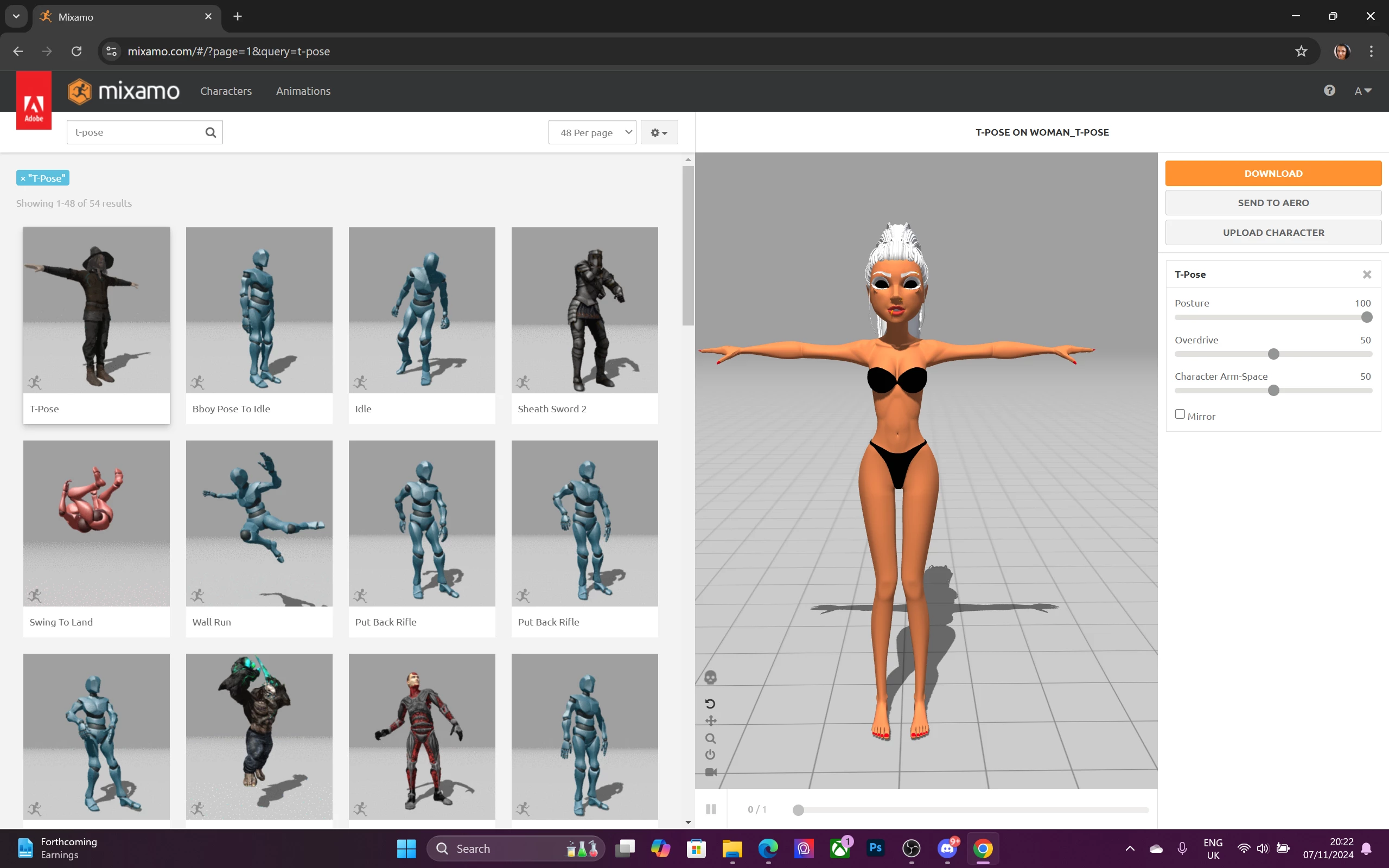

I managed to adjust the shoulders in the T-pose and they're symmetrical in all animations now 😉

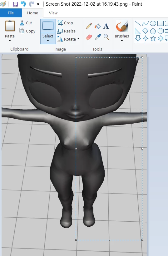

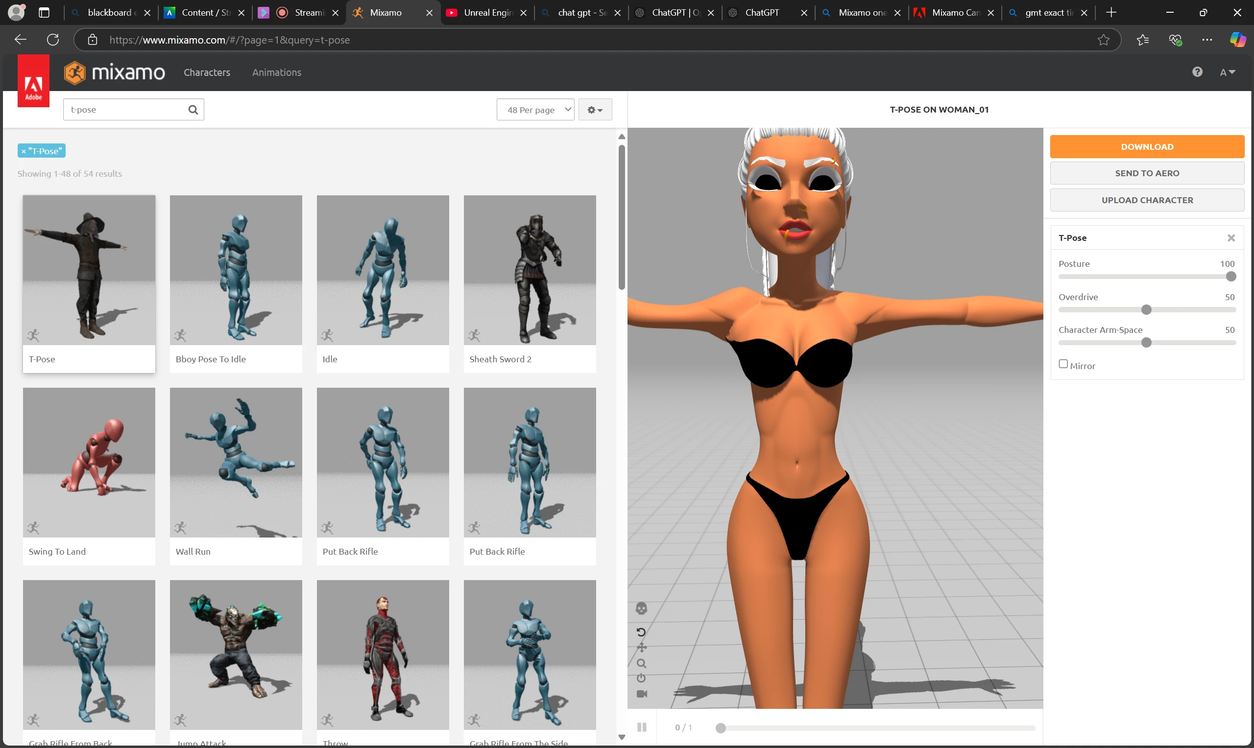

I guess I can't explain my problem..I already said my model is a symmetrical model the problem is that mixamo's rig is not symmetrical.
As it can be seen in the image I took, one foot of the character is in front of the other when i take a t pose after the automatic rig.
