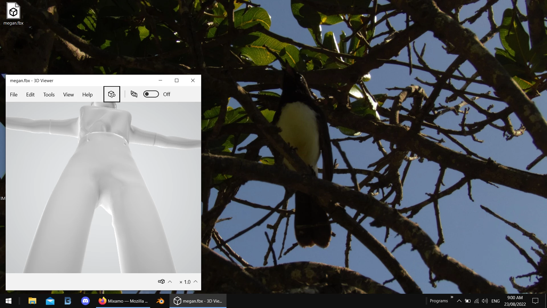

not at my end

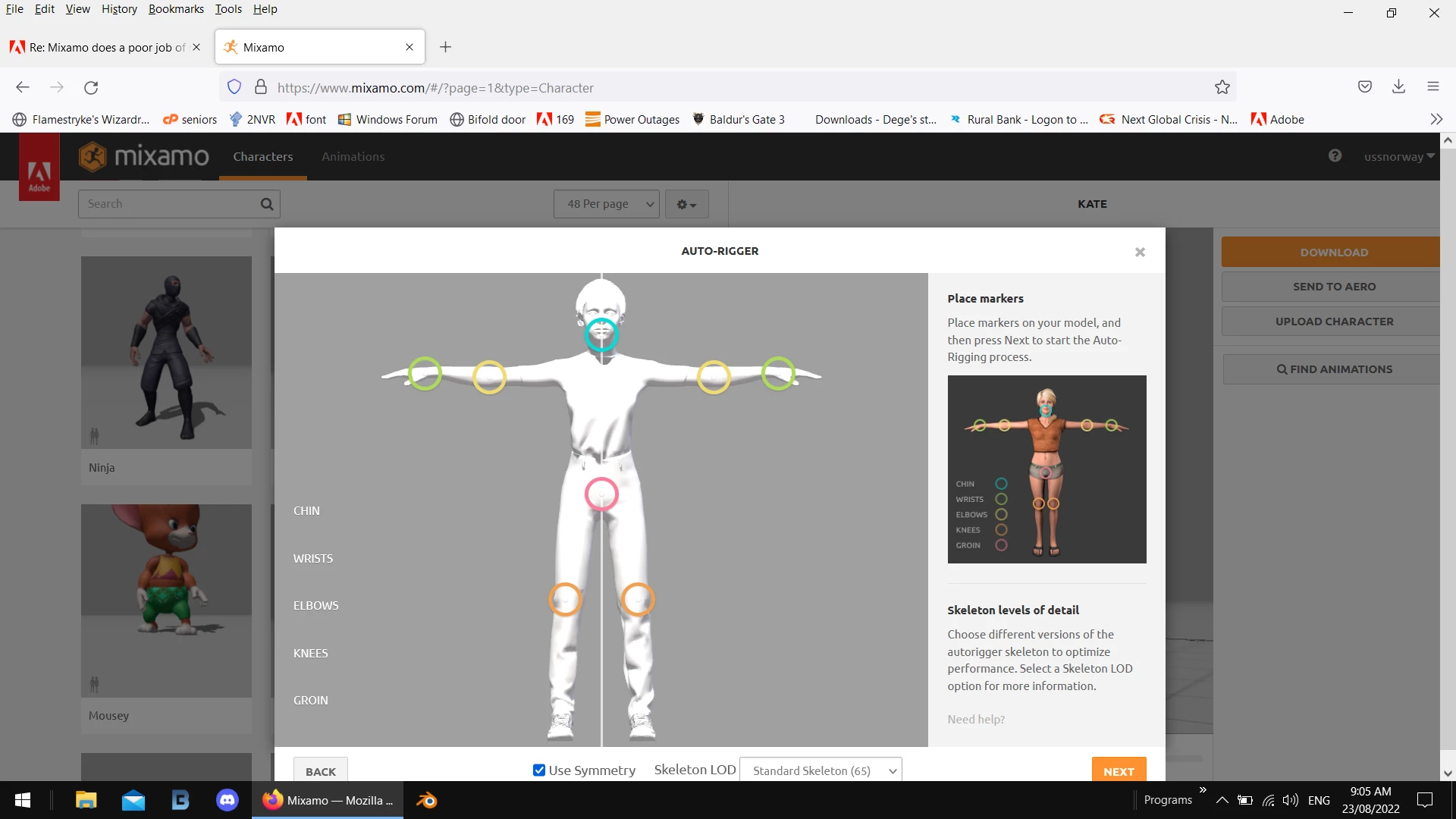

8월 23, 2022 3:10 오후 UTC
Thanks for the example, my friend!
I tried changing the grid in this place, and it worked fine.
The model is imported into Mixamo anyway without its skeleton. Miksamo adds the skeleton to the mesh itself. And the fact that you have to change the mesh of the character, of course, interferes, aesthetic design. But anyway, Miksamo is the only free tool of this decent level.
