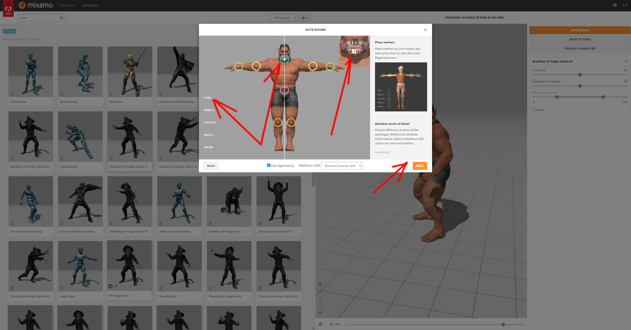

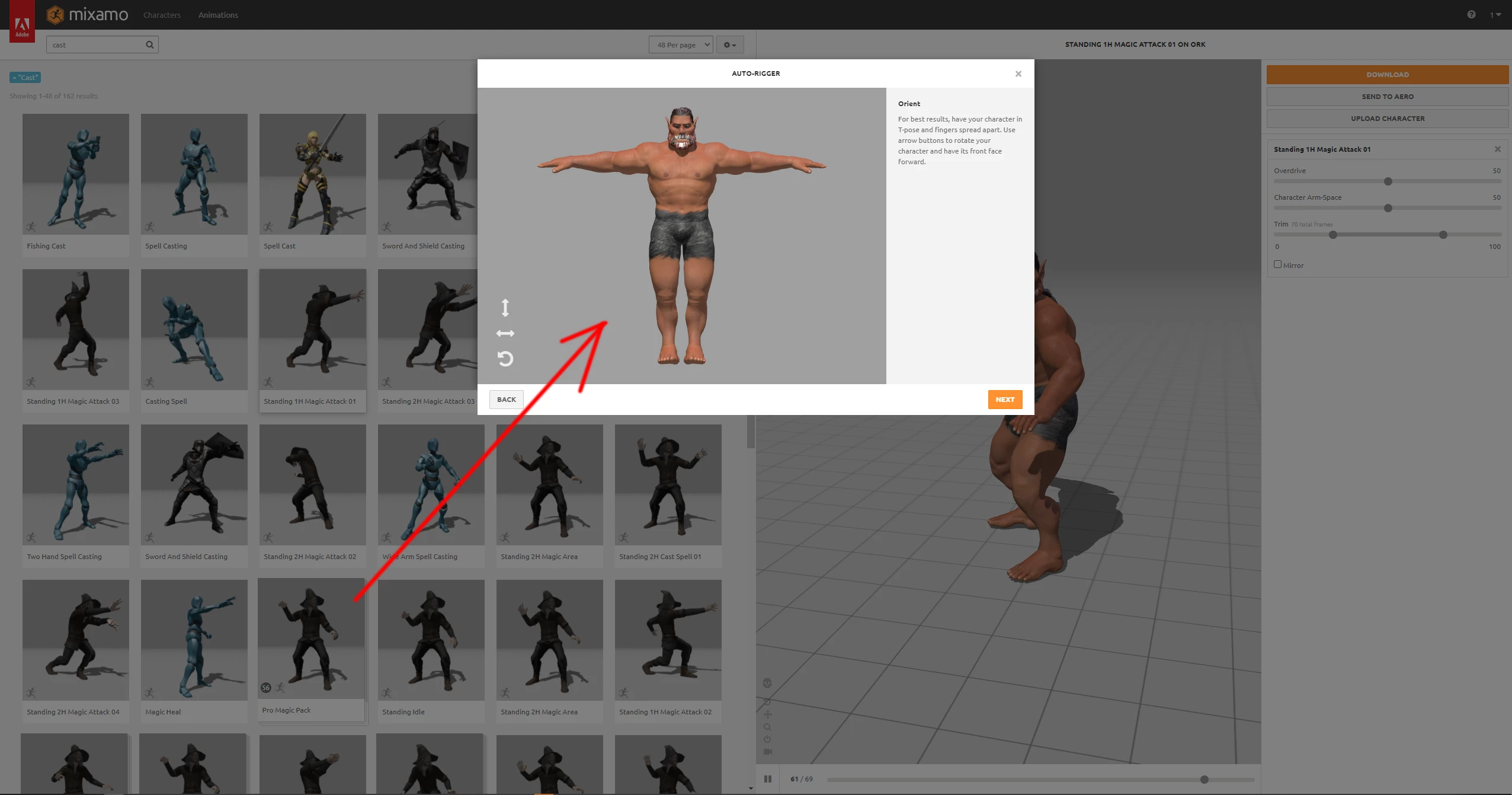

Mixamo model unnaturally distorts the beard. Where is the error?
Hi!
I have a model with a beard. I used to export it directly from Fuse CC and everything was fine. But now I can't do that and to get the animation, I load this model manually in the view .zip directly to https://www.mixamo.com/. But now, after placing the anchors on the joints, I get this result. This result will always be the same, even if I change the CHIN anchor position. I tried to export the model in different ways from Fuse CC - it doesn't help.
Video: https://radikal.ru/video/Wrnbxv7vyPZ
This happens even if the model is loaded without a beard and mustache - the jaw and chin will continue to be distorted.
Other all my models load correctly.

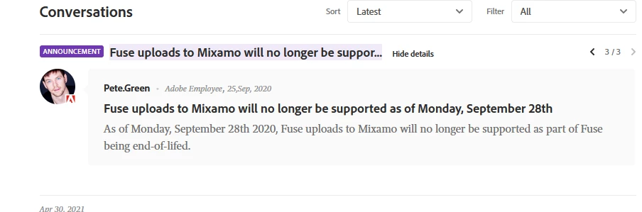

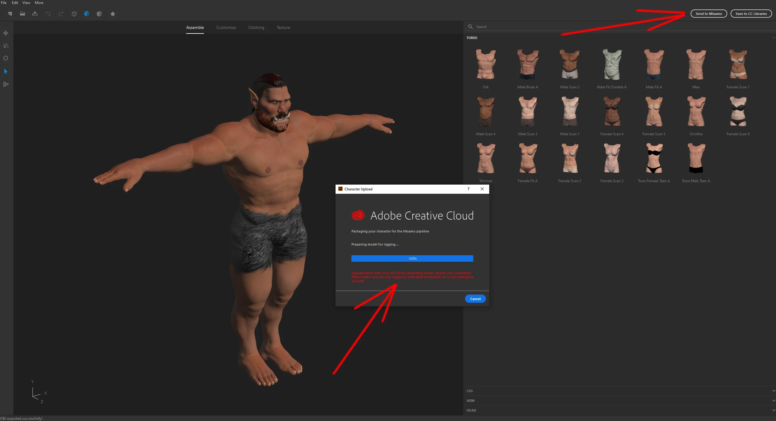

your model will not upload from Fuse to Mixamo because Adobe pulled the plug out of the wall and shut their server down
2nd the chin you uploaded to Mixamo in your second screengrab has been distorted by whatever software you used on the Obj Fuse exported out... was it Photoshop, Blender or Maya?
the Fuse model will have teeth as a different part inside the mouth and with a jaw \ mandible that big I would use Wrap but other software can do the job if you are ok with stretched textures... anyway yes it can be fixed but it helps to know what engine because Unity has its own issues

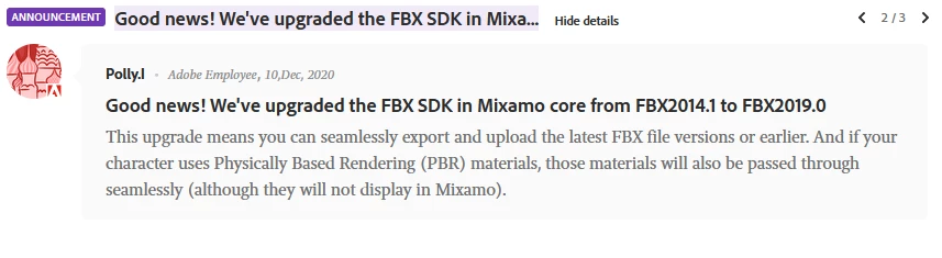

is it worth still buying outfits for Fuse = yes I think so and have many of the ones Steve (Arteria) makes + Holly https://cutsceneartist.com/ is probably the best person to talk to about getting Fuse to play nice with Unity however Adobe also changed their Mixamo file types so be careful following old tutorials with Fbx file types

>>> 1st your model will not upload from Fuse to Mixamo because Adobe pulled the plug out of the wall and shut their server down <<<
I already understand that, yes.
>>> 2nd the chin you uploaded to Mixamo in your second screengrab has been distorted by whatever software you used on the Obj Fuse exported out... was it Photoshop, Blender or Maya? <<<
Previously, when exporting from Fuse to Mixamo, there were never any problems with my models. And now, if I export obj from Fuse and manually upload it to Mixamo in the form .zip, then download fbx for Unity - these problems appears. The model mesh was once slightly distorted in Maya (teeth and groin), but using the basic grid in the Content Creator Package-Adobe Muse CC 2015.

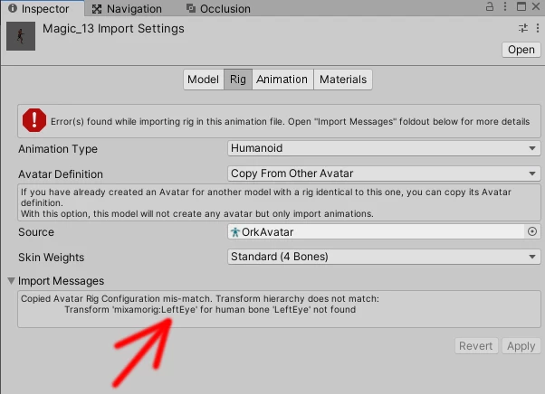

Volchok
VolchokAuthor
Apr 30, 2021 3:11 PM UTC
When connecting an animation with a curved beard in Unity to the internal avatar of an orc, this error occurs. Maybe this is the reason?
