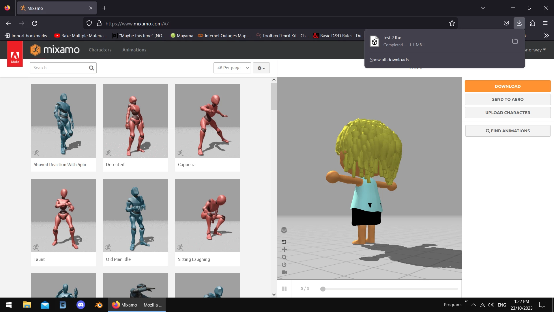

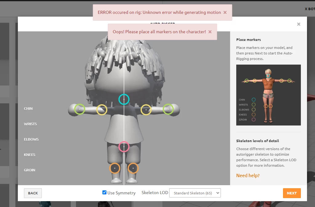

mixamo place all markers on character error
I know this question has been asked alot, but no idea how to fix it for this model, any suggestions? please

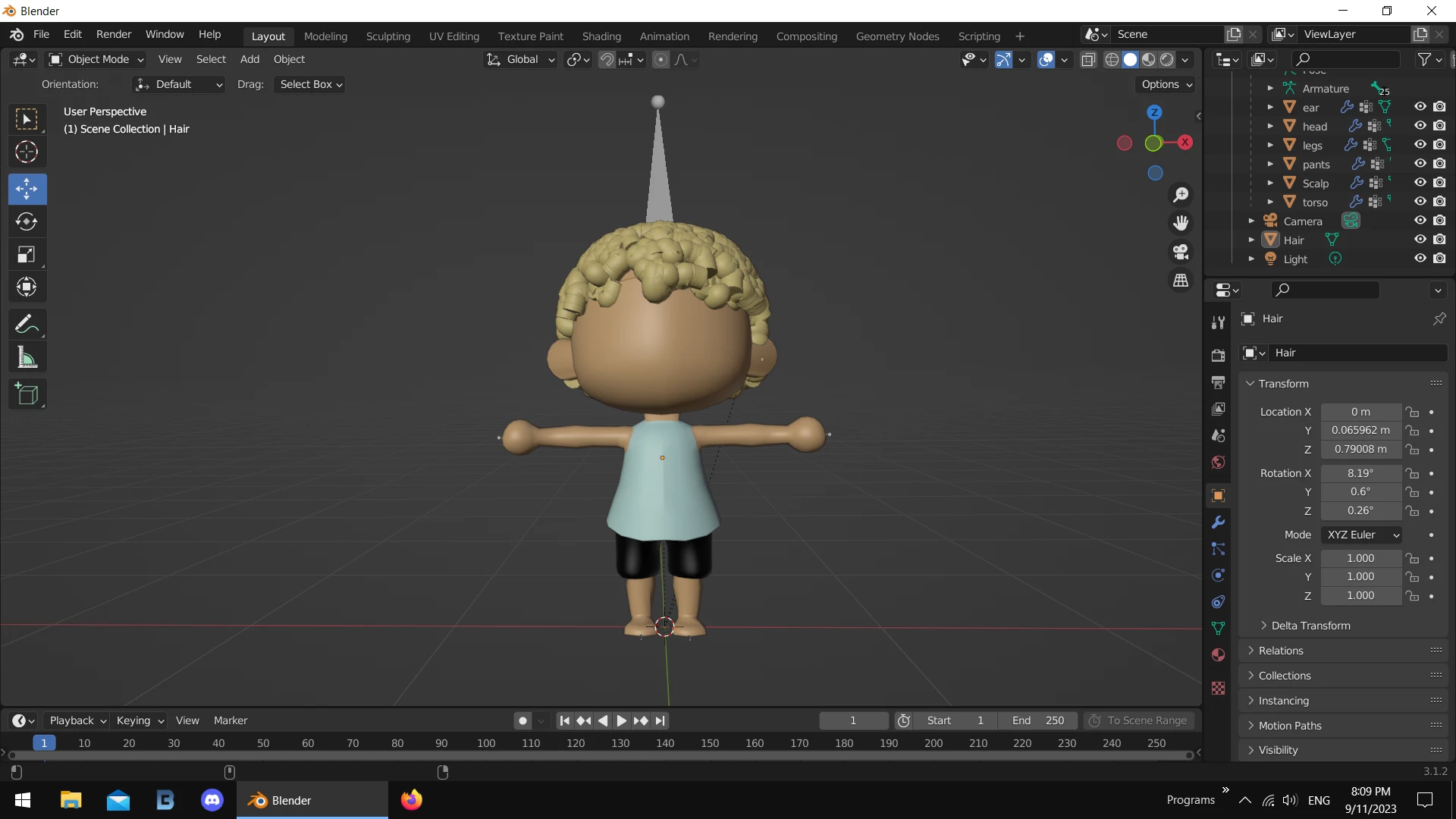

Nov 9, 2023 8:36 AM UTC
1 remove the hair
2 set the model onto the ground plane

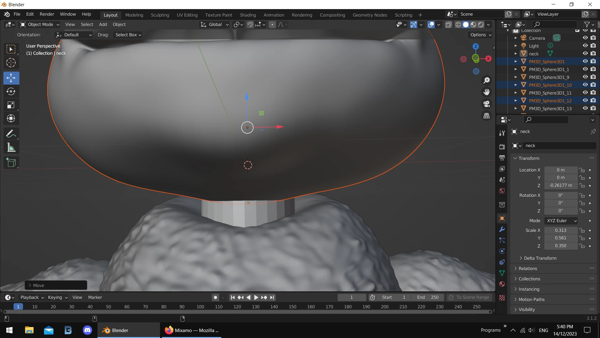

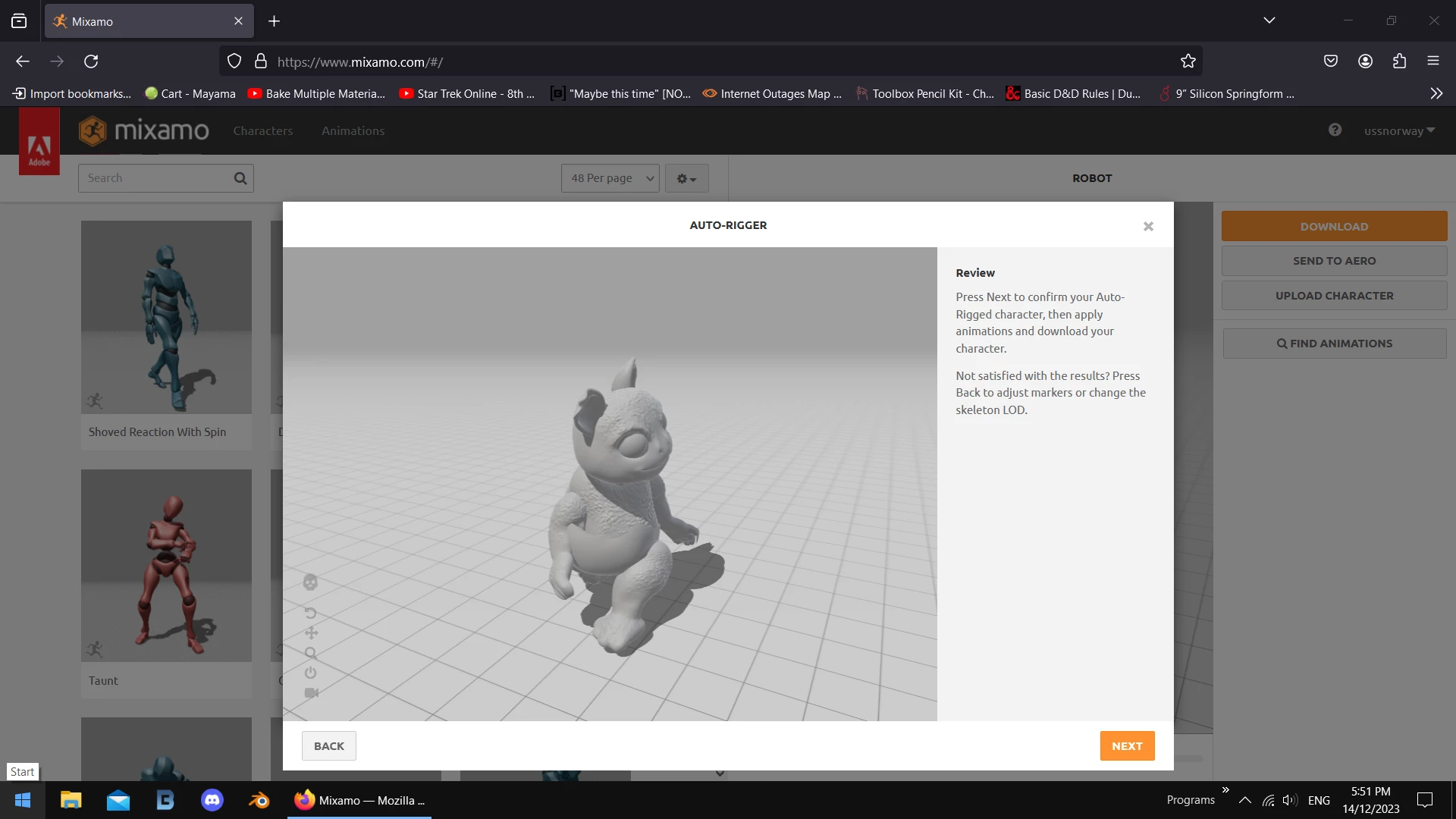

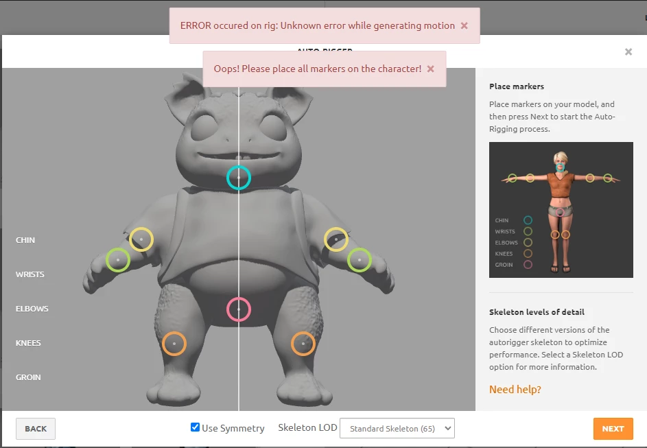

Hi! Please help me solve the problem! This is the first time I face such a problem. At first I tried to load the model with clothes, it gave an error, without clothes also does not want to make a rig
Ussnorway7605025
Dec 14, 2023 6:56 AM UTC
you need a neck

Oct 18, 2023 9:54 PM UTC
1 your screengrab shows a standard rig but your model has not fingers so there is that
2 the groin marker wants to be higher and so does the chin
3 i would check the hair is not touching any where but the head then also check the file size/ type
Oct 21, 2023 1:20 PM UTC
Did the first 3 steps but it still gives the same error, uploaded it as both fbx and obj, and still the same thing. It might be that the file size is too big, any suggestions on what to do? again really appreciate your help, you're a g 🙏
