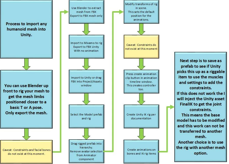

Thank you. And yes I saw the Tpose download option. I ws thinking it was in the animations. I tried it but it bent the model too much. The Tpose option was too much conversion from the hanging position of the original.
I will Tpose it in Blender and work from there. Have done this many times.
I spent 6 months in Blender/Rigify with no luck also there are no fingers in the workflow.
I found Maximo gave me fingers and worked the porting work flow real well, which I appreciate greatly. After this find I was getting results in two days and can now go back and rework the Tpose in my models and end up in Unity with really decent models. Attached is the workflow I found. My assumption is once people found this out they are so burned out and spent too much time finding this they have serious time to make up and dont bother with reporting publically. I can blame them.
