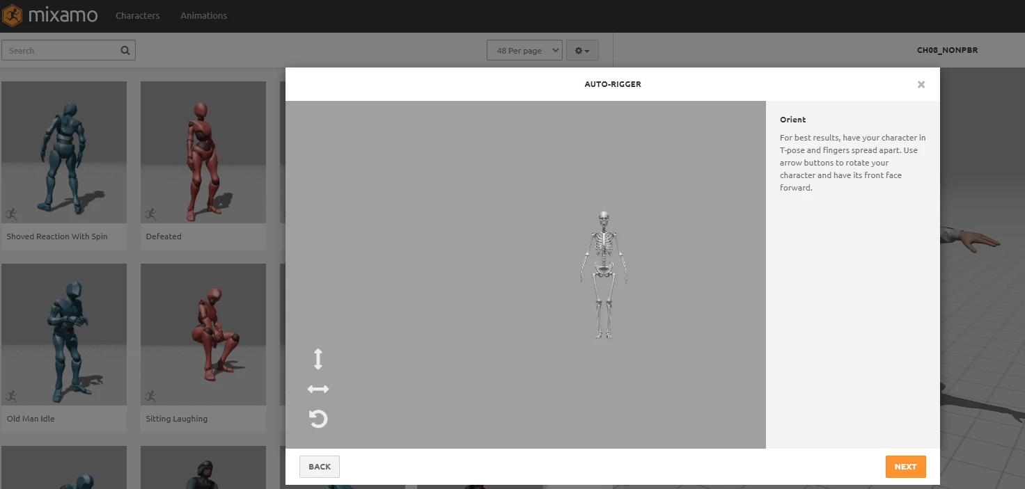

So I tried different ways, but still get this error.

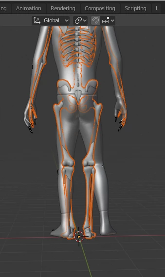

originally i used rigged .blend file, set skeleton in rest position, combined all the parts into one, set scale, rotation, etc.. at 0 and export as .fbx (try all the same with .obj - no difference) without rig bones, model it self (probably important?)
I am worried that model is not in the center when imported, so i need to place markers manualy (yes, it always "hits" the model, but I suppose that could be the reason of an error)
perhaps the error occurs due to the fact that the model has gaps? is it fixable?
Thank's for the help
my future projects are in danger... 😞

its the legs
the way you have them angled in makes the right leg look like the left and Mixamo tries to swap them around
as a side issue the chest will need to be fulled before it will rig as empty space does not work
