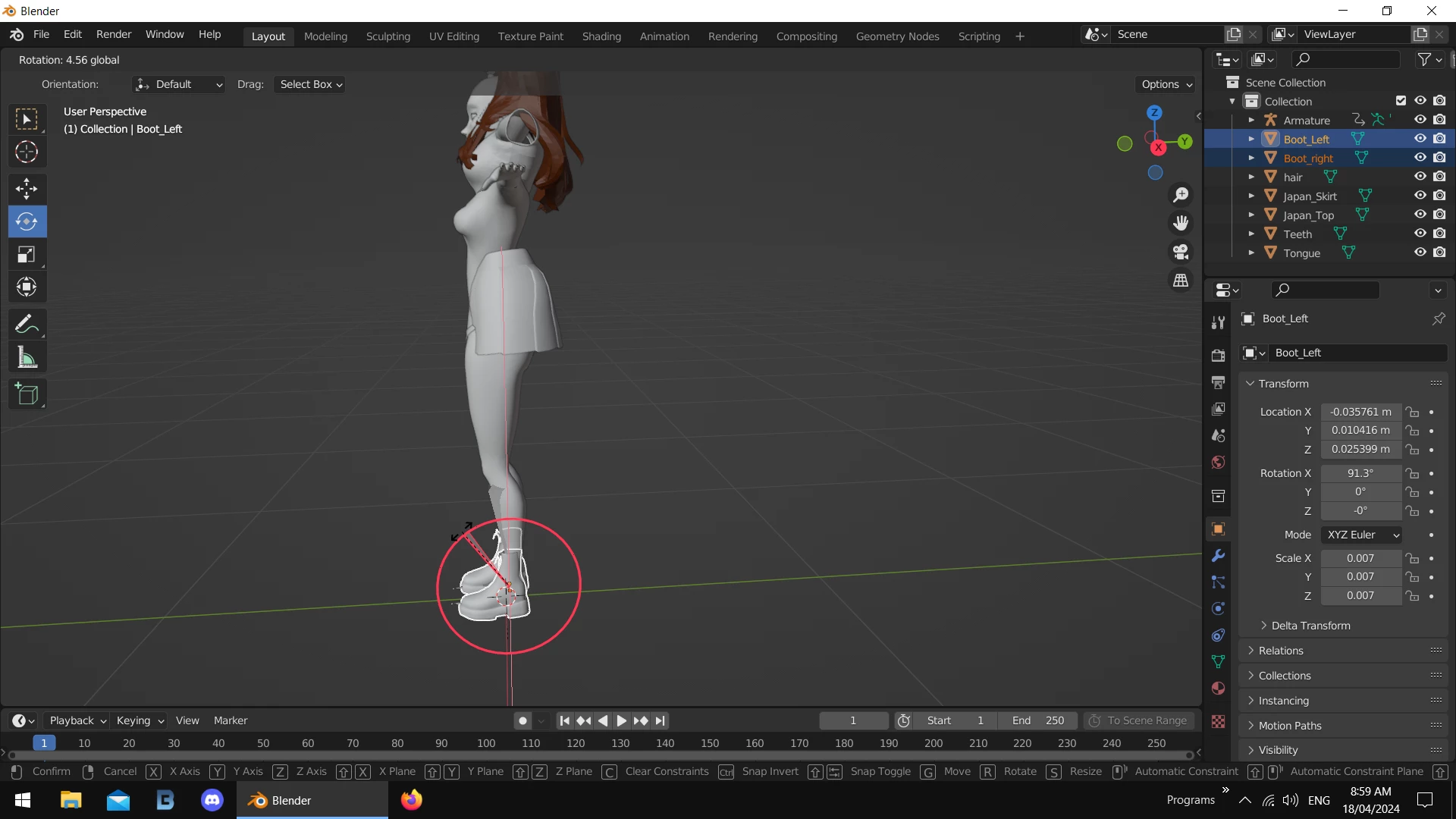

Apr 18, 2024 11:31 PM UTC
the first image is me moving bones to see which one controls what... the fact that both bones are in the same upperarm location is a mistake made by the person that edited it for sale
imo if you got this model from a stock then you should return it and ask for your money back

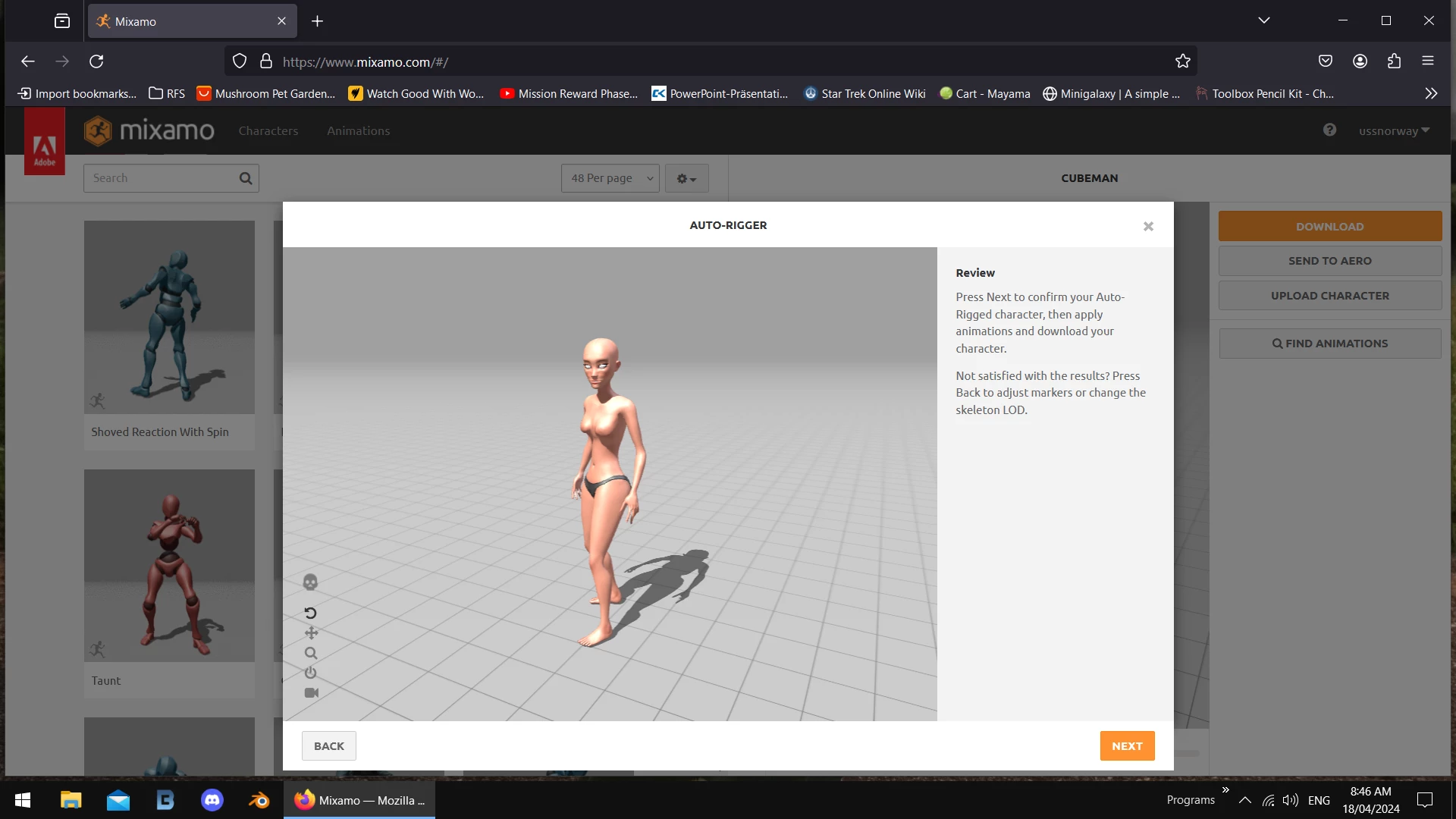

Apr 18, 2024 7:26 AM UTC
Thank you very much! It's working. I managed to load the model yesterday, if not export the rig. But when animating, there are distortions in the mouth and jaw area 😊. Your model is doing well. I'm not good at 3D yet, I found this model on the stock. By the way, in the first screenshot, the hand is curved, I don't have that when I open the blender file. Maybe it depends on the version, I have 2.83.20

Apr 17, 2024 11:54 PM UTC
Mixamo can NOT read weight bones so if you really need her tongue to wiggle use some other rigging ... The extra arm bone will also need stripping out
