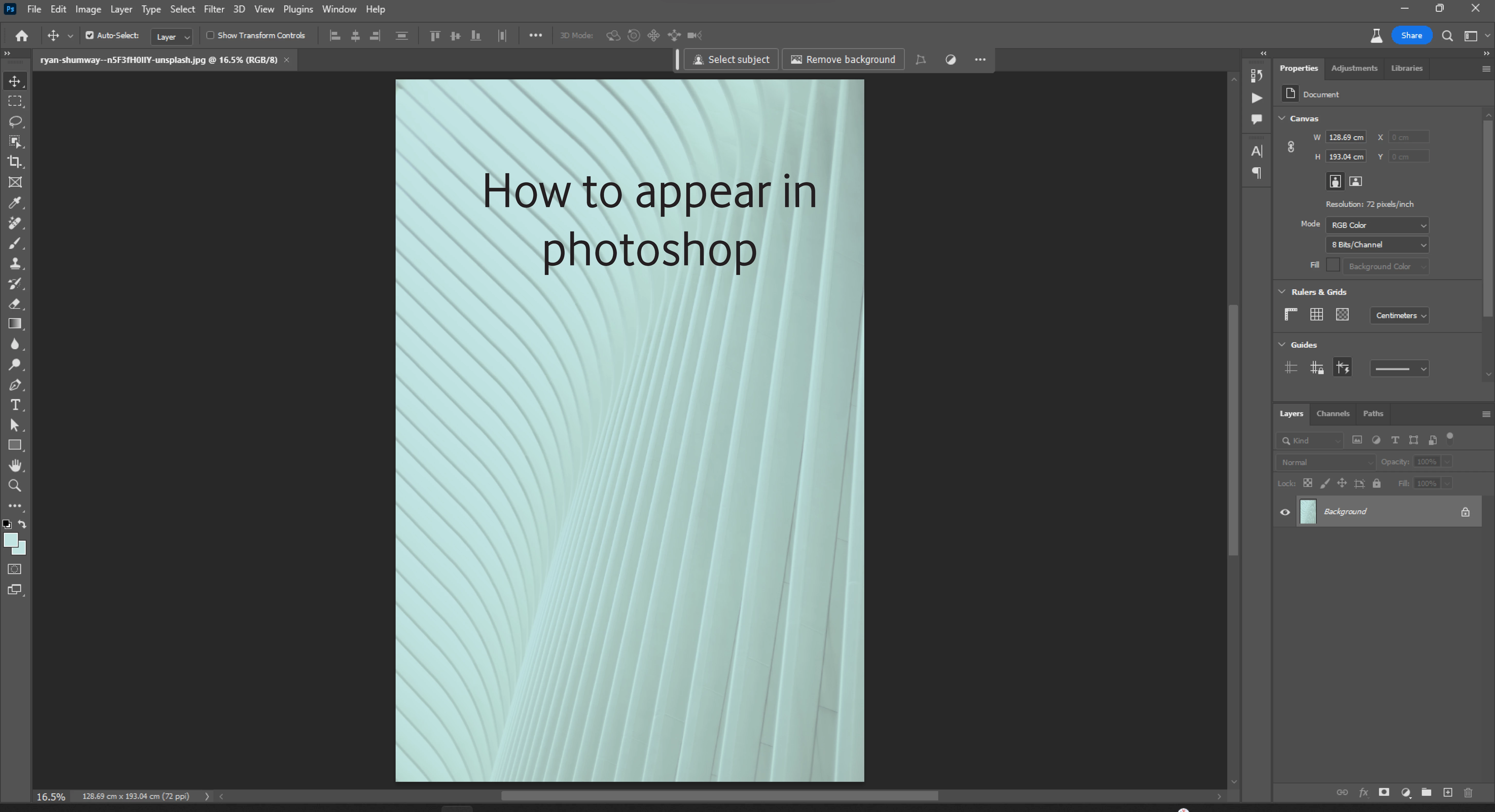

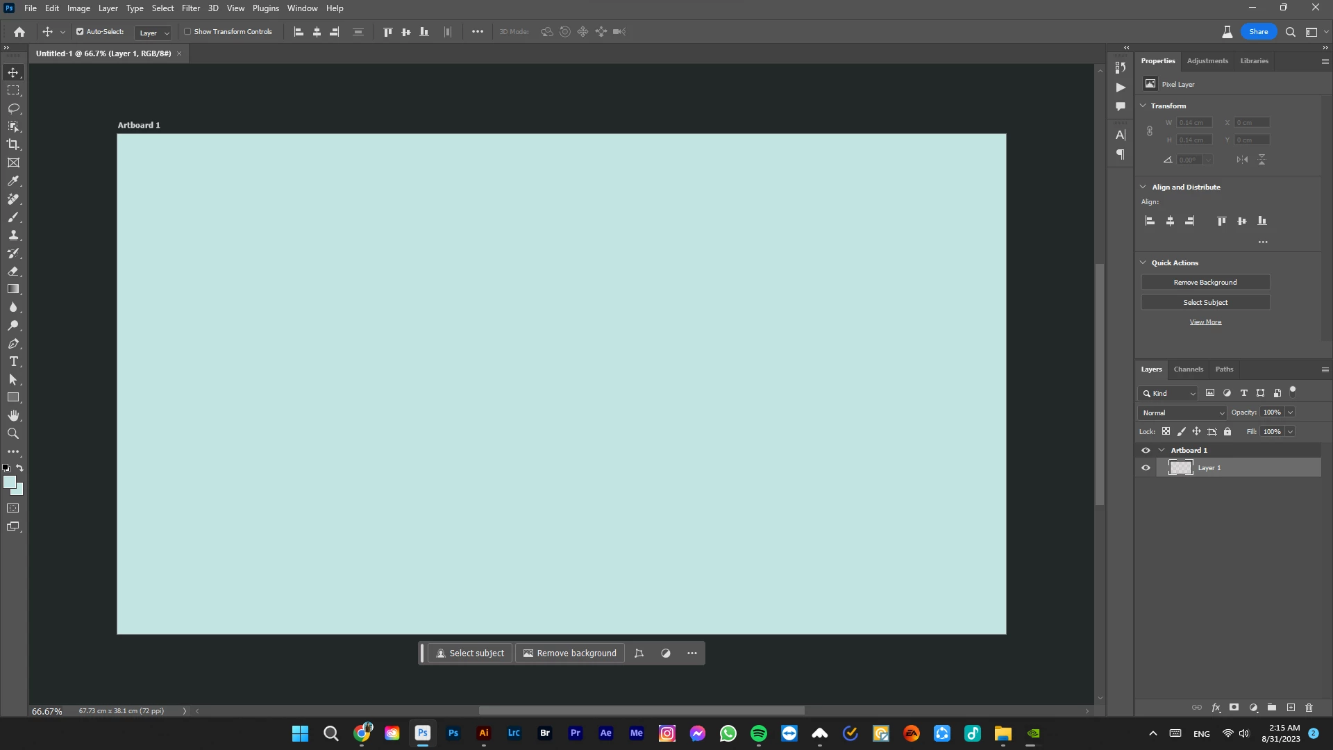

I have a problem in the beta version of Photoshop, which is as follows. When I open the program, the colors appear in a bluish color, as if there is a problem with the white balance, but there is no problem with the white color settings. The problem only appears externally.
The program is updated to the latest version (25.1)
