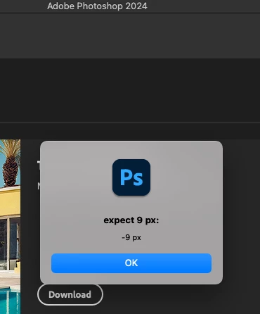

Run the following code
var test = 10 - UnitValue( 1, 'px' )
alert( 'expect 9 px:\n'+ test )
expected result:
Variable test should return a positive 9 px value
actual result:
Variable test returns a negative 9 px value
