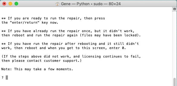

Again you will see the "are you sure?" screen, final instructions and a warning that this will take a few minutes.
Press Enter/Return to run the repair.
When the process is complete, you will get a message saying so. You may have to press Enter/Return to see the exit code telling you it's done. Usually that's "Tool exited with status = 32512"
Quit Teminal (cmd q) and restart Photoshop CS4 It should open without the 150:30 error and work as before.

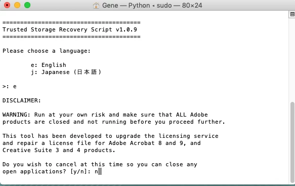

If you see this screen, you are good to go.  e  then press Enter/Return for English
n (Enter/Return) to start the repair or y if you forgot to close your Adobe apps.

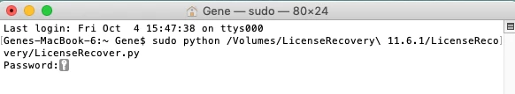

Next you will be asked for your admin password. Usually that's your own account, but it could be a separate one.
You will not see dots or stars, and the cursor will not move in response to your keystrokes, so carefully type in the password and press Return/Enter.

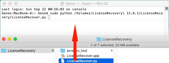

Next, drag the LicenseRecover.py file into the Terminal window.  If you see this command, you are successful and you can close the LicenseRecovery windows. Do not unmount or eject the Disk.
Now that the command is set up, press enter/return on your keyboard to run the script.

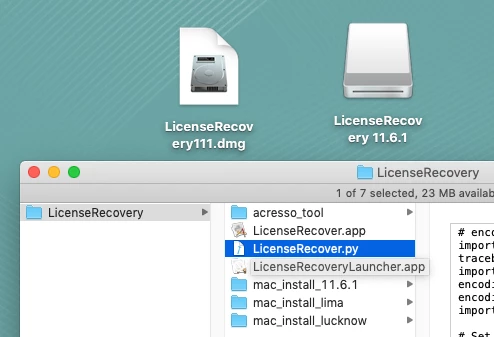

Next, click on https://www.adobe.com/support/contact/licensing.html for both the Windows and MacOS License Repair Tool. Mac users download the dmg file. Windows users download the zip file.
Double-click on the dmg file to mount the Disk on your Desktop.
Double-click on the disk and navigate to and select "LicenseRecover.py" (highlight).

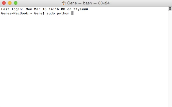

First let's open and prepare Terminal.  Terminal is under /Applications/Utilities  Double-click Terminal.app to start. Type sudo python after the $ prompt, and add a space as shown below. It's needed to make the command run properly
