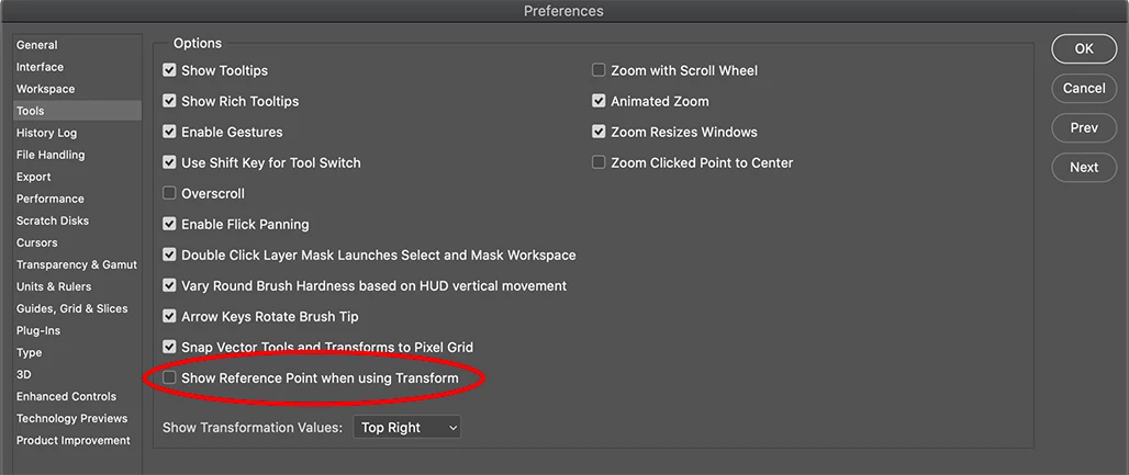

I assume you turned it on via preferences first: Tools> Show Reference Point When Using Transform. Then use the Option-click to move the anchor point. Still there. If it is not working reset your preferences via Preferences>General>Reset Preferences on Quit.
smithanyAuthor
December 4, 2020
After backing up my pattern files, a few ATNs, kys and mnu files, I begrudgingly gave this a shot and unsuprisingly no dice.  I detest having to do that because there's a hundred settings in workspace layouts and preferences that need to be reset and or reimported, but it did not change the behaviour and both times, before and after resetting preferences, the check box for Show Reference Point when using Transform was selected.  I may try without 3d accelleration on, but I seriously doubt that is related.  I may also try emulating click with AHK and see if I get different results and will post back, just in case there's some driver issue with my mouse, but it worked fine in all previous releases up until 22.0.1
