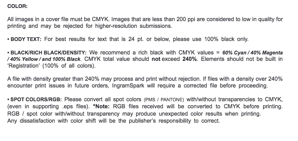

    This is from their guide, which reads like it's from 1997. They only reject higher than 240% total ink if they've had problems with previous jobs you submitted. 60|40|40|100 is a built color, you would never get it with a conversion from RGB:
    You also should keep the ink limit in perspective. They are hedging against very large areas of total ink coverage, something like an all black background on a book jacket. So unless you are running full page coverage of separated black, I would think it would be safe to use SWOP or another coated 300% profile.
    With online printers you really are on your own with prepress decisions—there isn't going to be an intervention. Ingram doesn't give you any info on their press profile, doesn't provide a profile that would limit the ink to 240, and ironically will accept PDF/X-3, which allows RGB. They would have to have a press profile in house to deal with RGB to CMYK conversions.

    Has Ingram actually rejected a submission with 300% total ink images? Their documentation is a bit confusing, but I think they want US SWOP CMYK for images (300%) and the 240% limit is their requirement for hand built rich blacks in the page layout.

    these POD publishers are notorious for having confusing and less than helpful “help” files. I had a quick look at the site’s File Creation Guide DPF file and was not overly impressed.
    Images should be in CMYK, however there is no explicit mention of *what ICC profile to use*, ideally you would have either their preferred simulation profile (usually an offset press profile) or the profile of their digital printer that is producing the colour pages (HP Indigo, Kodak NexPress etc).
    They do mention a 240% total ink limit, however this is only under the “Rich Black” specifications, it is unclear whether this also relates to photographic images or vector illustrations.
    Their screen captures show their export settings using the ubiquitous “U.S. Web Coated (SWOP) v2” ICC profile, that by design uses a 300% total ink limit.
