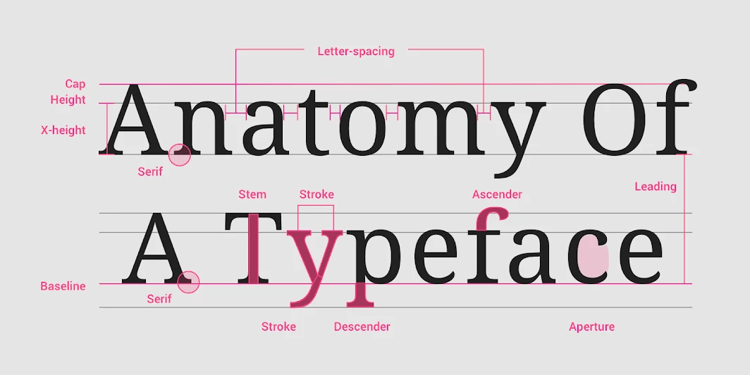

If you accept the statement regarding computer type that one inch is equavalent to 72 points, then 3/8 of an inch would be 27 points.
FWIW: I was brought up in the world of hot type where the x height of a font may be different among faces of the same point size... fonts were referred to as "large on the body" (with short descenders) or "small on the body" (with long descenders) so there was no single calculation of converting points to inches based on x height. It was not designated based on including ascenders and descenders either, but on the height of the surface on which the letters were cast. The body.

Type is measured by the size of the metal block, just as Gutenberg did, and the size includes the parts of the letters that ascend above the x-line and descend below the baseline, whether or not the Ascenders and Descenders exist. It is typically measure in points, because that's what Gutenberg did.
That being said, since your client has given you a measurement in inches, be aware that the size of type in Photoshop may change depending on the pixels per inch (ppi) of the document.
Will the final copy be printed? What is the ppi? What format are you giving back to him?
If you have upper- and lower-case, then find out what the customer wants. If it's all caps, I'd print it and measure then get it signed off.
