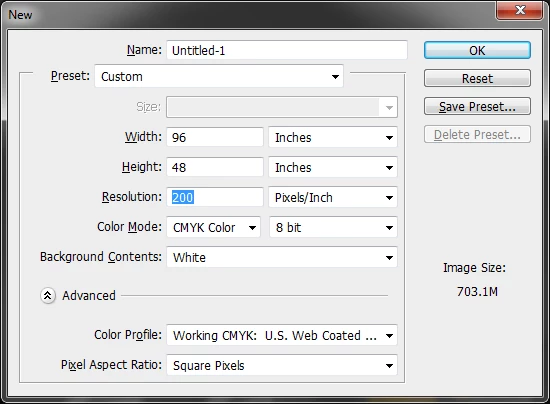

Hello there!
I am creating a "menu" board for an auto service center.  The board needs to be 4x8 feet - and I'm wondering how I go about setting that up in Photoshop.  No idea what the canvas size should be, the resolution (although I've heard 300 dpi), etc.  Help!
I'm trying to fit it all on one document - but I feel like the text is too small - and worried if customers will even be able to read it from 10-12 feet away.  Any help would be super appreciated!
Thanks in advance!
Erin

    Ernie_0920
    December 11, 2017
    Thanks, Wildcat54!  Ok - so I created a document and filled in the canvas specifications just like you did above (I just reversed the 48 and 96 numbers around).  Once I complete designing the document - is that what I will send to the printer - in Photoshop format?  And it will stay true to size?  Sorry for all of the dumb questions - I've never had to create something on this large of a scale before - I'm a beginner!
    Thanks!
    Erin
    WILDCAT54
    December 11, 2017
    Stay away from .jpg on something this large.
    I would save as a PDF or TIFF for the printer. Always keep your PSD file though.
    Your document will always stay true to size as long as you don't resize your document.

    WILDCAT54
    December 11, 2017
    You'll want your document to be the final size as you are working with non scale-able rasterized graphics.
    Save often as your computer may not like handling a document this size depending on your computers specs.

    WILDCAT54
    December 11, 2017
    I agree with
    The document can be made at a fraction of that size and saved as an .eps to be shared with the printer without losing quality.
