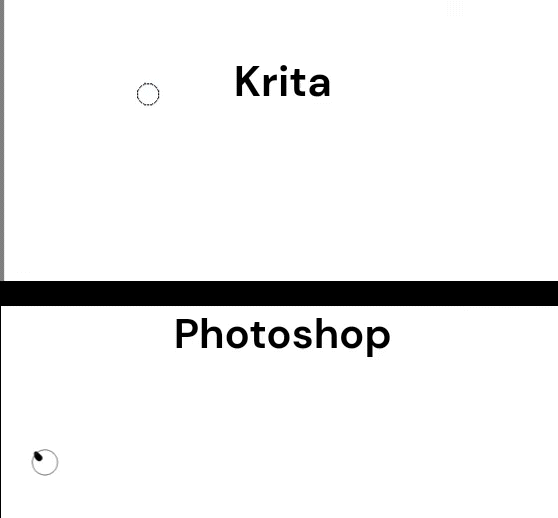

Hi there! I'm trying to learn Photoshop after using Krita for years. One thing that is driving me insane is that the brush cursor doesn't reflect the size of the brush based on pressure.  In Krita, when you draw, the cursor size changes based on the size of the line you are creating. You can see in the gif above what I'm talking about.
Is this not a thing in Photoshop, or is there a way to make it reflect the size more accurately?
I guess not.
But feel free to post a Feature Request (mark the thread »Idea«) on the issue.

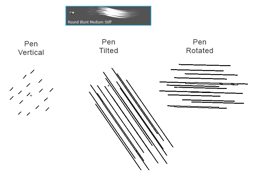

I also noticed that the cursor isn't rotating on tilt brushes.
By @Usor2
Also not true if you are using a pen tablet that has that feature.
This is using whatever pen came with a Wacom Intus 5

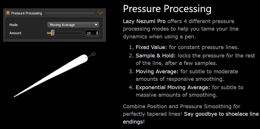

I see you are using Windows. If you don't already have it, give Lazy Nezumi Pro a try.  You get some time to try before you buy, and it's the best $30 (I think) you can spend for a Photoshop addon if you use a tablet.  It works with Krita and all drawing apps, and has a ton of useful presets, but what made me think of it in your case, is that it has a mappable pressure curve which gives you way more control of line thickness.
