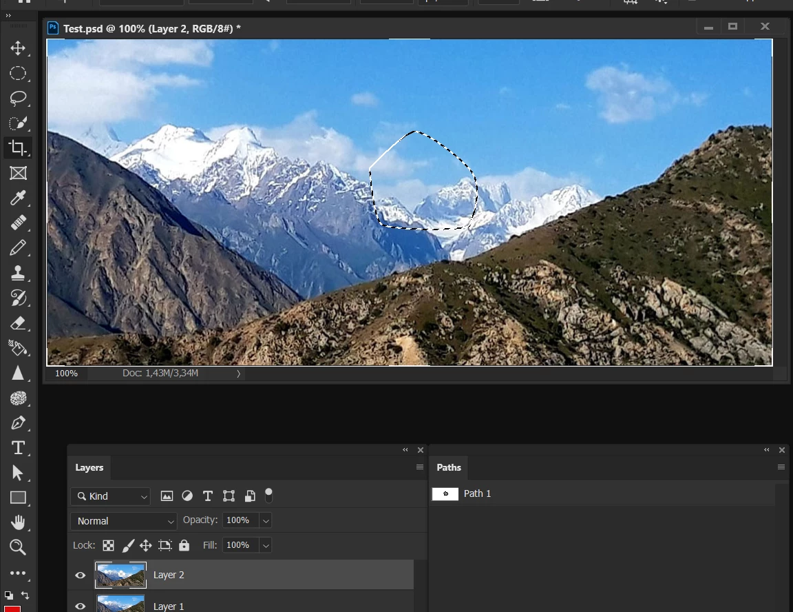

c.pfaffenbichler
May 3, 2023 2:43 PM UTC
Please save the Path and deselect it before running the Script.
AnyONAuthor
May 3, 2023 2:53 PM UTC
I save the Path and deselect it before running the Script...
Resalt >
c.pfaffenbichler
May 3, 2023 2:55 PM UTC
quote
Resalt >
So it works as intended. (Maybe hide Layer 1)
The clear applies to a Path or a Selection.

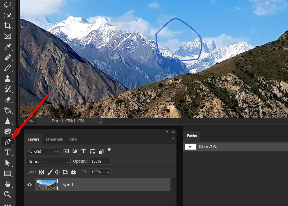

AnyONAuthor
May 3, 2023 1:35 PM UTC
 I also tried various editor states, and noticed this feature.
If in the Paths panel, the Work Path layer is selected (tinted with white), then no cleanup occurs. But if you remove the selection from the Work Path, then everything is fine
c.pfaffenbichler
May 3, 2023 1:54 PM UTC
Again:
Could you please post screenshots with the pertinent Panels (Toolbar, Layers, Paths, Options Bar, …) visible?
Screenshots that illustrate the actual start- and end-point of the Script in this case.
Try saving the Work Path as a proper Path by assigning it a name.
