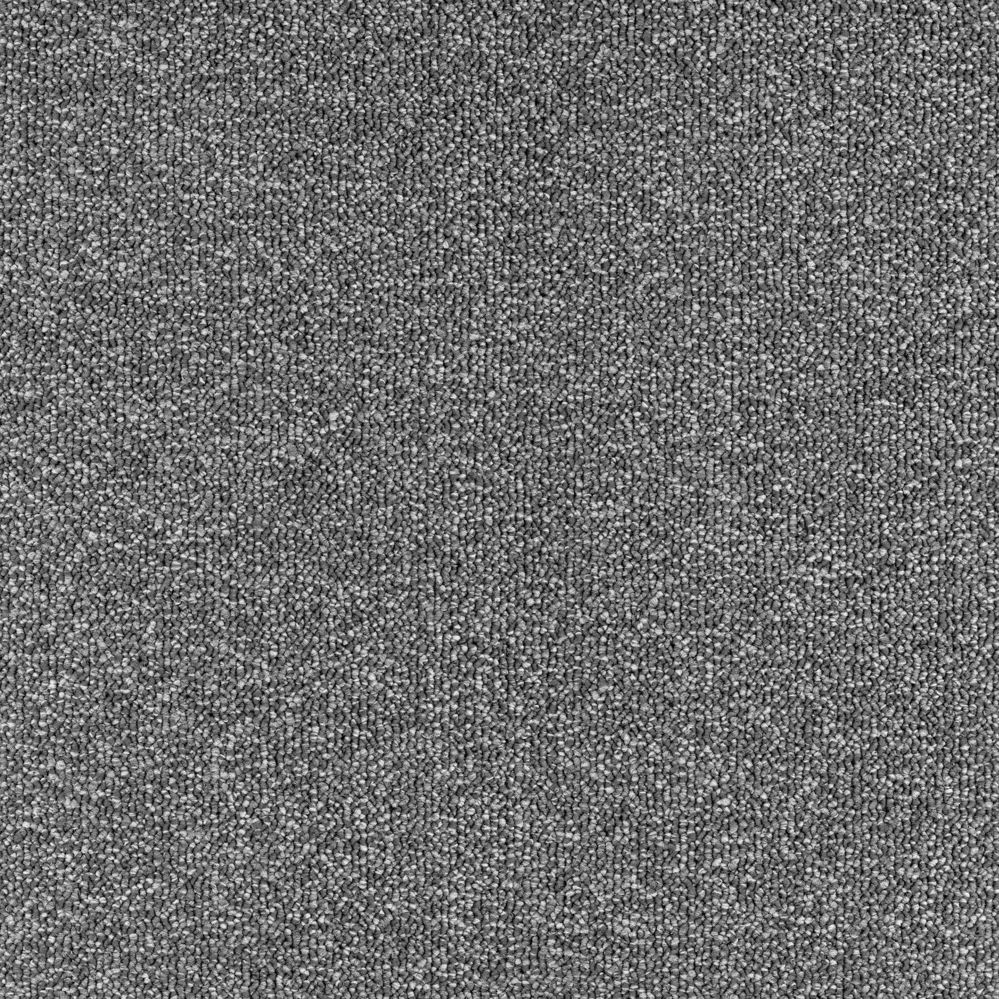

I need to digitise 50x50cm carpet tiles to be able to lay (or tile) them together in a 3D program for room planning.
To do this, they must be absolutely uniform in brightness. So not darker or lighter at the top or bottom left or right.
You can't achieve this by scanning or photographing.
Now I have thought about dividing the image into several grids and assigning the same brightness values and ideally colour values to each grid element.
but i have not found a way to transfer an absolute brightness value or curve.
attached is a scanned and stitched carpet tile. It looks good at first.
but if you tile several of them together, the picture is very uneven.
or do you have an idea?
Thx reinhard

    You might try Substance 3D Sampler.

    If you doing this a lot, then Substance Sampler is the way to go as it has the tools for de-lighting, tiling (which can be AI driven) and will derive PBR material maps including Basecolor, Roughness, Height and Normal ready to work in a 3D application.
    That said if you are only working on that single file then turn pattern preview on, set the eyedropper to a large sample and add some points to view in the info panel. Then use a series and of curves and paint on their masks to limit their application. The aim being to lower the variation across the tile without losing the local texture. Each curve adjustment will be slight.

    Lookup flat fielding. Flat fielding is the process of taking a photo of the same area with a sheet of white paper and then merging those two so the white is evened out, or flat fielded. Both PS and LR support flat fielding.

    Rather than using high pass as described in this ground breaking article from 2001, use the more common frequency separation method popular today.
    https://www.gamedeveloper.com/art/the-power-of-the-high-pass-filter
    Sadly the images weren't carried over from the original site, which makes things harder to understand. Edit: try here for the pics -
    https://web.archive.org/web/20211108134331/https://www.gamasutra.com/view/feature/3073/the_power_of_the_high_pass_filter.php
