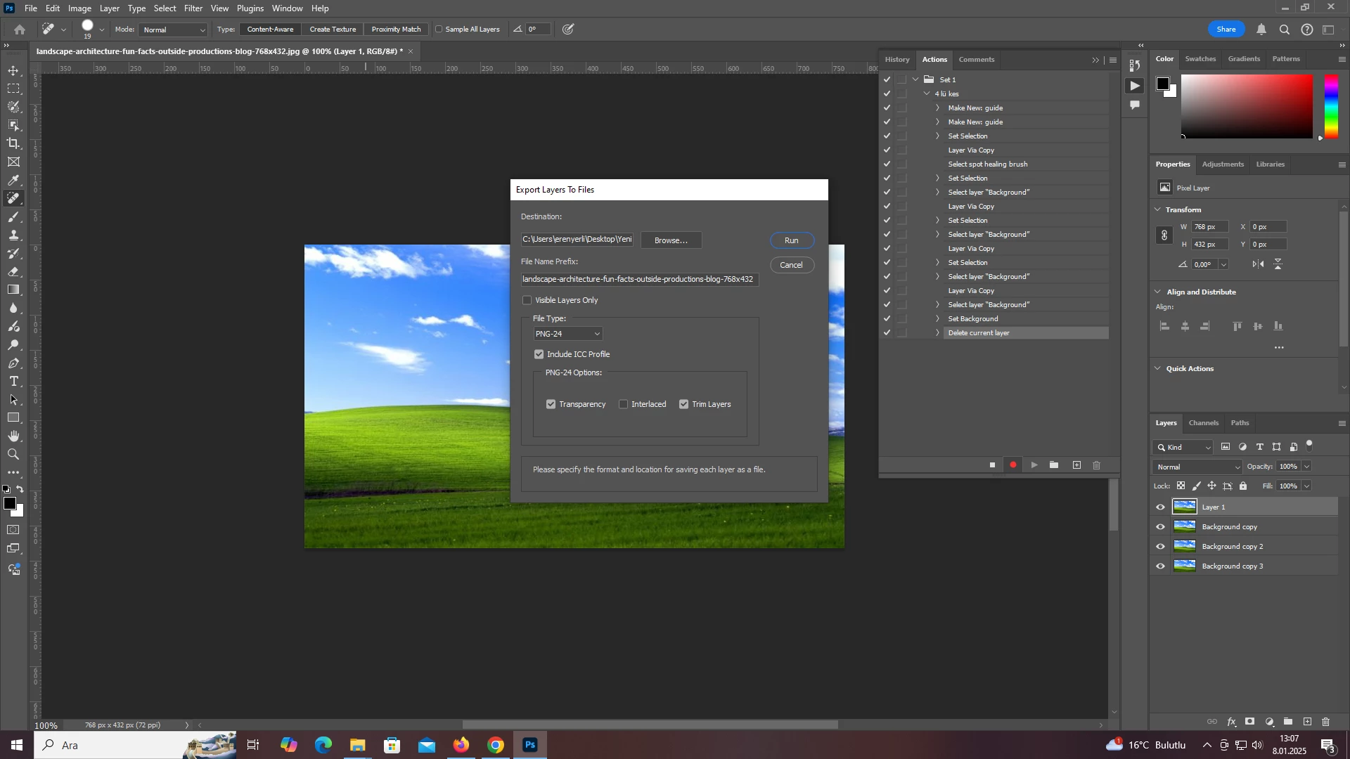

Stephen Marsh
January 8, 2025
@ancientartwork
The Export Layers to Files script is not intended for recording into an action for running via Batch.
If you are recording the Export Layers to Files script into an action, then please show that action step expanded and the panel wide enough to view all recorded content.
Use the script that I mentioned earlier, which is intended to batch process multiple files+layers.

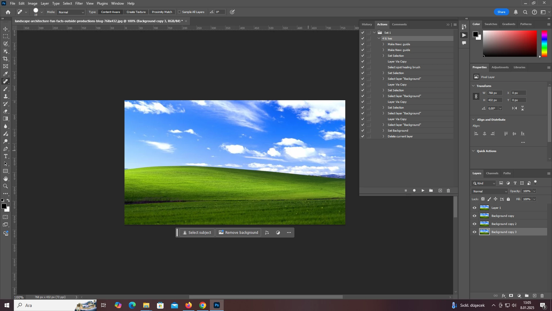

ancientartwork
January 8, 2025
To see the action in action.
We are making 4 different cuts, since the image is an example, it seems like there is no cut in the layer due to the size difference, it works fine at the right scale.
We add the output to the action and everything works fine.
However, when I select bulk operations, each image produced is written on top of each other.
This does not happen when I take the images one by one and run the action.

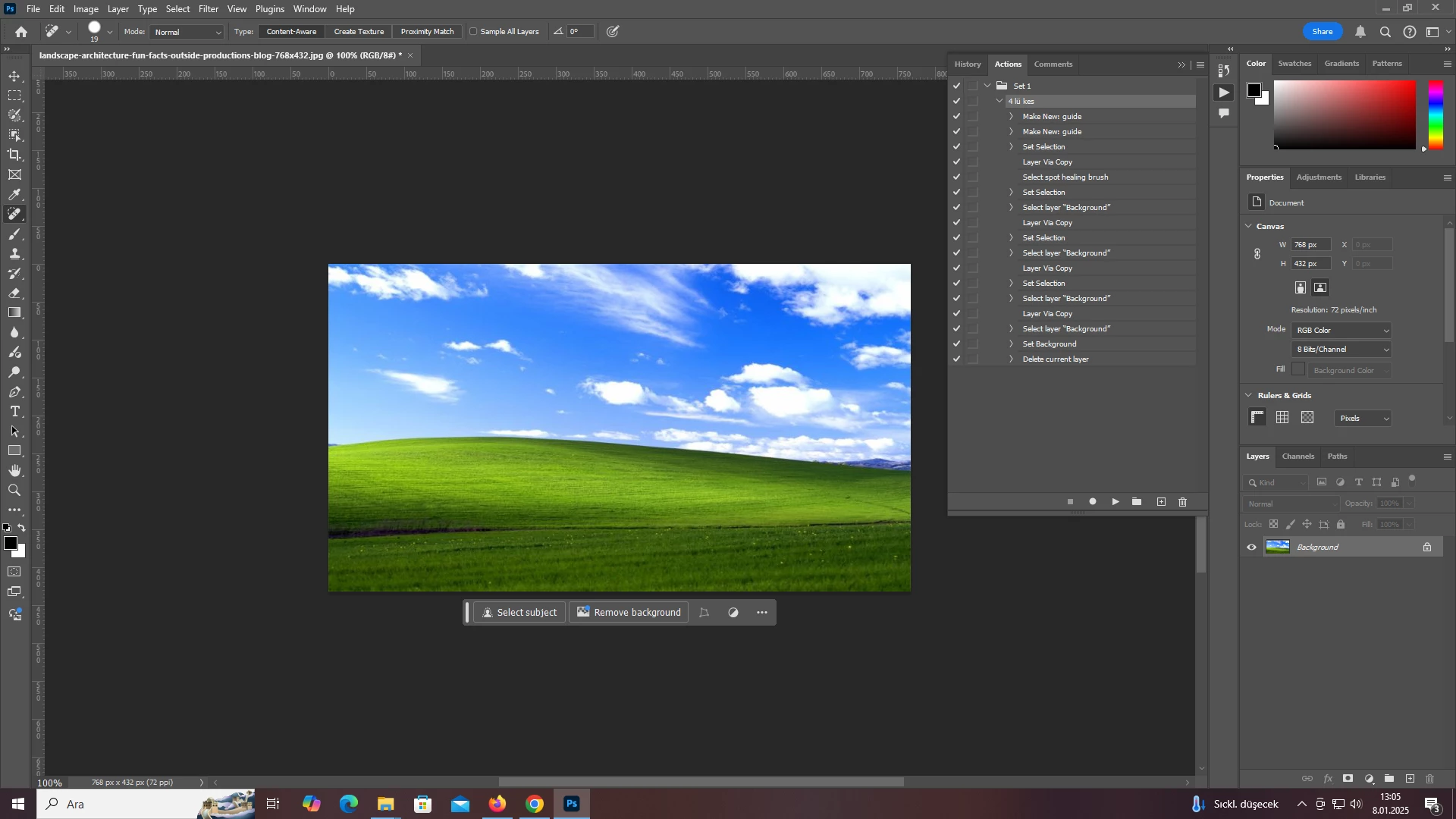

ancientartwork
January 8, 2025
1 image is imported.
With the action:
with the shortcut m, it is divided into 4 different images and the background is deleted.
the save part is exported to layers to file: output is taken, when you run the action with different images, it saves them separately.
However, when you run the action with the image processor or batch, it saves the images on top of each other.

Stephen Marsh
January 8, 2025
quote
I save with Layers to file, no problem here.
By @ancientartwork
Please explain exactly what you do, step-by-step.
I don't know if you are referring to the File > Export > Layers to Files script, or something else.
Stephen Marsh
January 8, 2025
It would be helpful to see a screenshot of the action with the save step expanded, and also a screenshot of the batch settings.
Anyway, I think that you would get a faster result using something specifically designed to batch-process files and layers (presuming multi-layered files):
https://www.marspremedia.com/software/photoshop/save-layers
As you are working with PNG, the script might need minor modification to play your action to create the layers on each opened file (otherwise batch pre-process the PNG files with the action to first create the layers and save as PSD, then process the PSD files with the script).
