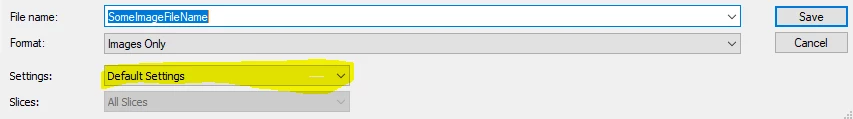

I had the same issue and I've used this 100's of times before without issue, this really irritated me. The fix I found is while recording during the Save portion (Save for Web > Save > Save Window Opens), there is a drop down below the file name that says "Settings:" - it is set to "Default Settings" you need to change this to "Custom" and it will work as expected saving each file under its original file name separately. When recording the save portion I save the first image to a new file folder to not overwrite any of my existing files to be safe.

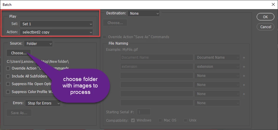

Easy solution to use action as it is: use File > Automate > Batch instead of Image Processor Pro. You must correct one mistake: you have Copy step at the begining of action and it is causing error message. Record step like Select > All before copy step in order to make action work or exclude first three steps which are not necessary for action to work and deliver what you need as end result. You will see during batch process several Save dialogues where you can name your files as you want.

Here is how your Batch dialogue should look like:

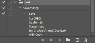

Then you need to recode a Save As step for  some image file type like jpeg that only records the destination folder in the action step no file name so the step will default the file name to the current documents name. You can batch that action and override the destination folder using options.  If you expand your actions save as step so you can reads the settings recorded  you will see it has a file name and extension recorded into the step's settings. You do not want that. Do not set the file name when you record the step.  Do not alter the file names field in the save as dialog.  If you do that will be recorder into the action step.  You want the step recorded with no file name set just the folder set like the action:

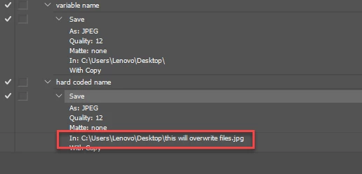

You probably have hardcoded file name and photohop is always saving file with the same name what is causing to overwrite existing file. Can you expand step to save and post screenshot? Or upload action somewhere and post link so we can examine and modify it if necessary.
Below is screenshot with the difference, second action will always overwrite existing file and you will always end up with single file in your batch process.
