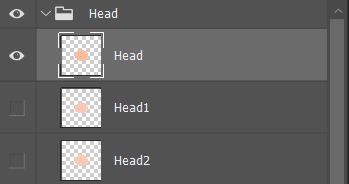

I need to create a function to turn on layers from an specific folder when button pressed.
Here is a screenshoot to make it more easy to understand it.
Thanks in advance!
Correct answer r-bin

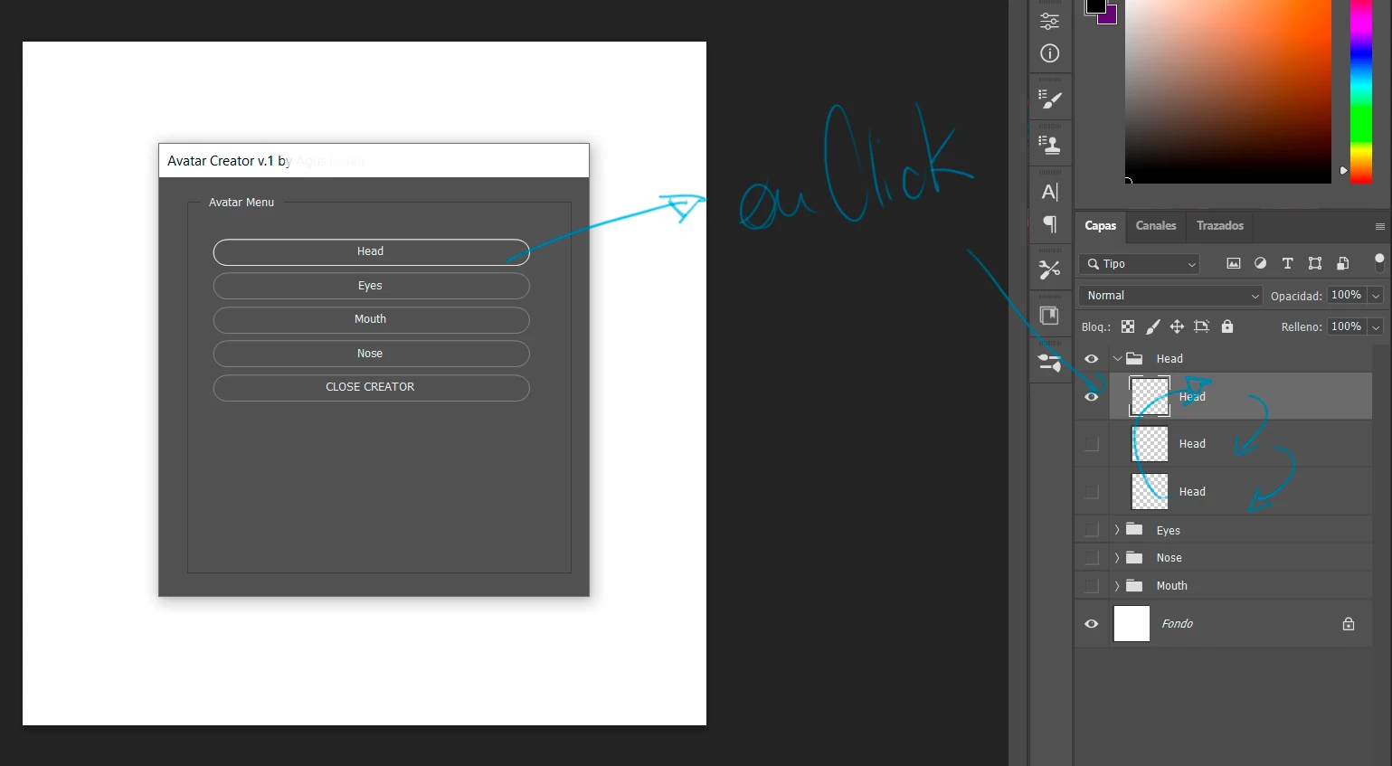

My original idea was to change active layer when clicking button (like the attached GIF). I need to create a simple avatar creator, so I will have multiple faces, ears, hairs, etc. It's my first time with PSD scripting. I don't know if it is a better solution for this. Thanks!
var set = activeDocument.layerSets.getByName("Head");
for (var i = 0; i < set.layers.length; i++) if (set.layers[i].visible) break;
i = (i+1) % set.layers.length;
for (var n = 0; n < set.layers.length; n++)
    var viz = n==i;
    if (set.layers[n].visible != viz) set.layers[n].visible = viz;

Thanks for taking care of this issue! It worked but It turns all "Head" layers inside the group at the same time. Is it possible to turn only one layer at when clicking?
September 28, 2021
If multiple layers have the same name, how would the script know which one to show?
