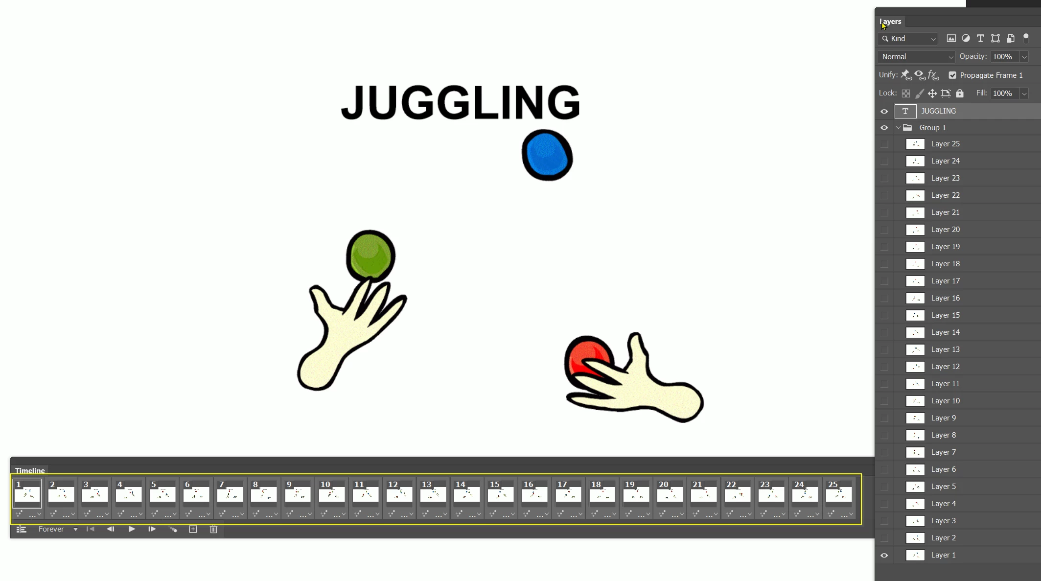

With Photoshop it's simply a mater of selecting all of the frames (this is important) and adding the text layer to the top of the stack.  It really is that straight forward.  If you find you get out of sync, then select all of the frames again, and turn the text layer off, and turn it back on again.  That should sort it out.
Sorry, I have never used Elements.
